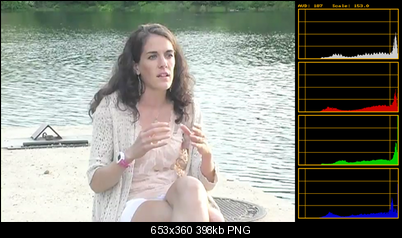

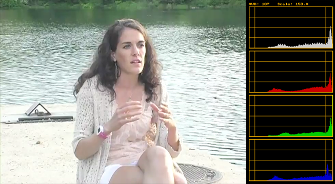

    Very nice cuts and seques, but persistent use of incorrect IRE, and highlights destroyed in most shots or blown out to almost-white:
    I did what I could with bad levels, but had only the low-bitrate .flv from UTube. Worked levels and color only, didn't address compression or deinterlace artifacts, spotty dissolves, or other noise. Couldn't rescue many of those highlights. The original audio rate is non-compliant for DVD, BluRay, or AVCHD (it's 48k in the attached mkv). The final product for your couple should have a lot more bitrate than the flv. With your cool edits and ideas, the bride and groom ought to have nice color as well. Your encoder will like you for it, too.
