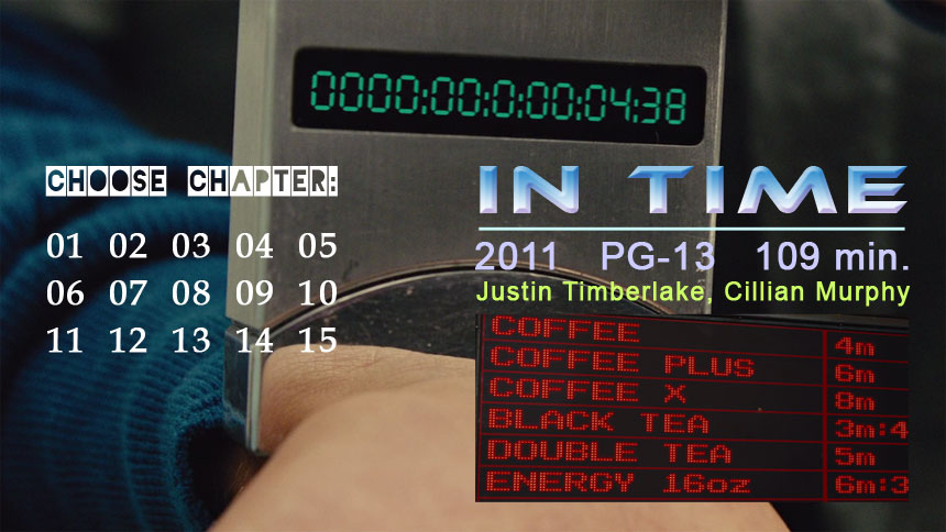

    The first 5 are so simple that just about any DVD authoring program will accomplish them.
    You would think so, but have you actually ever heard of, or tried to author a DVD that has ONLY a chapter menu? That's what I'm trying to do.
    You can help matters along by making a 720x480 BMP of how you want that menu to look.
    Well it's a little bigger than that, but it's 16x9 format:
    [Attachment 18369 - Click to enlarge]
    Another statement that belies your claim to have researched this thoroughly. 4:3 or 16:9, it doesn't matter. The menu will still be 720x480. You should be able to use yours once you resize it to 720x480 and encode it (or have it encoded, as I described earlier) for 16:9.
    I'm not sure if you're telling me that I'm a liar or that I'm stupid, but another statement that belies your implied claim to be a video (and therefore an image) guru, is that x/y ratio doesn't matter. If your end project result is to have a 16:9 ratio, then it's best to start with, and design in a 16:9 ratio. Otherwise you're likely to run into stretching or shrinking problems, and people and objects will be perceived in the wrong ratio. In other words people will look taller or fatter than they actually are (I know females that would not be happy). You probably realize that you can fix this with content aware scaling, but why go to the trouble if it takes less time to just design properly? Also, I don't know if you read this earlier, but I had no goals or tests in mind when I made that test menu. I was just experimenting and playing around. I don't intend to use it, since I don't care enough about that movie to back it up again. I only picked that movie because it was the easiest to grab a screen shot from. I am aware that the most common of the NTSC disks are 720x480 (there's other sizes too). I was not going to go to the trouble to open it up again, and scale it to your preferred size.

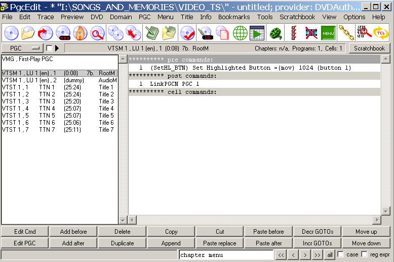

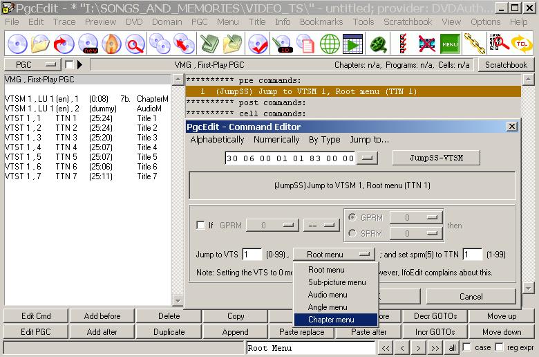

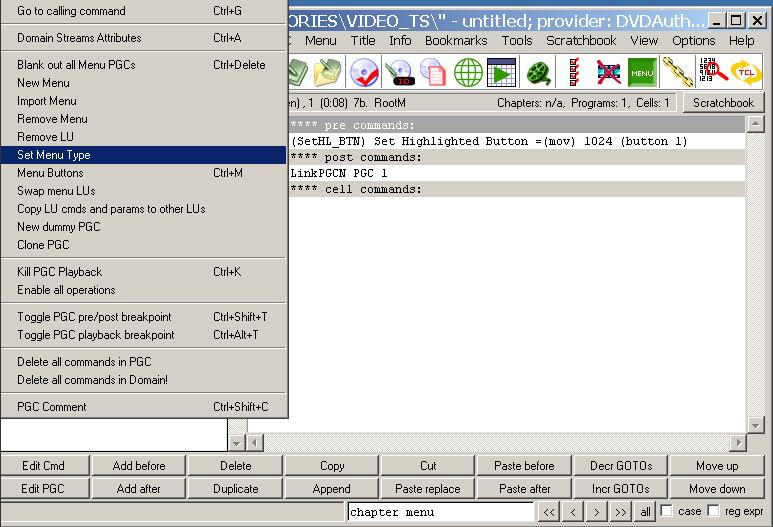

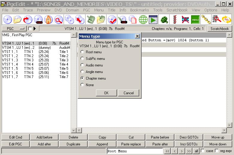

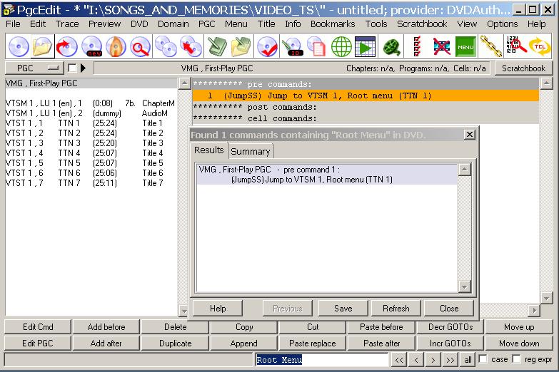

  13. Originally Posted by dipstick666 View Post
    Despite claims of knowledge in this area, nobody has given me a clear answer.
    Nonsense. And I even showed you an example of one out of many I've done. Sure, it consists of episodes, but pretend each episode is a chapter. I set it up so that after playing each episode it returns to that one-and-only menu. I could just have easily had it continue to the next episode/chapter/cell, whatever you want to call it.
    Again, if I sound the least bit snippy please keep in mind that above all else, I do appreciate your help. Having said that, I'm not sure if you grasp the real nature of my problem.
    The problem is of your own making. You should probably set it up to be the root menu (as mine is). It's probably not a good idea to designate your only menu as the chapter menu. But it doesn't matter in the least that your root menu consists of buttons and menu commands for a bunch of chapters/cells.
    Aren't those titles of individual videos or movies?
    Yes, they are six titles/PGCs. They could just as easily be six cells/chapters within the same title/PGC.
    For some stinkin lousy reason though, I just can't seem to make a DVD menu that is the only menu on the disk, and it is a chapter menu.
    You're right in that I didn't understand the important thing to you was that it actually be called the chapter menu. As I've explained, I don't think that's such a good idea. What possible bit of difference could it make to you that it's called a root menu as long as you can access the various chapters from that root menu?
    Do you really not know, or is this another dig? Yes, I've made many menus, VCD, DVD BD, and otherwise.
    Nope, just asking. So this whole thread is all about actually being able to name your only menu the chapter menu? You already know how to create the menu and the buttons and menu commands and everything else? OK then, even if your authoring program doesn't let you name that first and only menu as the chapter menu, but wants to name it like every other single-menu DVD ever made, as the root menu, then afterwards you can use PGCEdit to rename it as the chapter menu and redo the menu commands so they point to that chapter menu and not a non-existent root menu. I have absolutely no idea why you'd want to do that to begin with, though - make a single menu called a chapter menu. Not ever having seen one, I don't know how your remote control would get back to that menu while playing the DVD. Maybe by hitting the 'top menu' button it'll return to the menu.
    So, yes, I included that picture earlier because I figured you wanted to see an example of a single menu consisting only of buttons to go to chapters. It never dawned on me until today that having that menu named as the chapter menu was the whole point. One can only wonder why. None of your seven numbered requests detailed in your first post mentioned anything at all about that single menu being named the chapter menu.

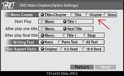

  14. Member p_l's Avatar
    Montreal, Canada

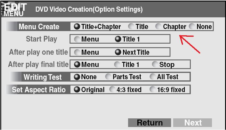

    Given the requirements and specifications of DVD structure, is it possible for a disk to have ONLY a chapter menu?
    Short answer: Yes, you can. I do it all the time.
    The catch is I do it with a Toshiba RD-XS35 DVD recorder which is as excellent as it is hard to find these days.
Name:	Toshiba RD-XS35 DVD Creation Options - Chapter Only.jpg
    Although with DVD authoring software I used to make mostly episode menus (from separate titles), I think I also remember making an occasional chapter only menu (from only one title), for example the 4th still menu in post #19 in this old thread (my brother's wedding).
    I haven't done a chapter only menu with DVD authoring software on the computer in a really long time (I'll author the occasional Blu-ray nowadays), so perhaps someone who uses current versions of DVD authoring programs can pick it up from here and give you specifics, but at least you now know that it can be done.
    Wow, that looks like it might work great for what I want. Too bad it's bundled in hardware. I found one of those on Ebay for $138 with shipping, but it was not even functional.
    Thanks for the examples. More ideas for me.
  18. I'll walk you through changing a Root Menu to being named a Chapter Menu in just a sec, but there's something else.
    NOTE: You could skip this paragraph if you don't care why I want what I want:
    I was interested but, to me, your reasons make no sense. Authoring programs use templates that don't allow for more than six chapters? So don't use a template. I don't use any of the commercial ones, but I don't believe the TMPGEnc Authoring Works mentioned earlier by ronmaz, while it has templates, requires the use of templates. The same with another one highly regarded around here, DVDLab-Pro. I expect most could use your picture (if it were resized to 720x480) and create a button for each chapter number on it. I know DVDAuthorGUI can (but don't know about using it in Win8, as I mentioned). The number of buttons allowed is limited only by the DVD specs (36 for 4:3 menus, 18 for 16:9 menus). I expect that's true for most authoring programs.
    Up until a few minutes ago I was under the impression that what you call a certain menu, actually meant something. My understanding was that there were Root, Title, Chapter, and Settings menus, and each of them had certain functions that could not be overridden or exchanged.
    Nah, call them whatever you like. The Root Menu can have the chapters, the Chapters Menu can have the subtitle choices. As long as the other menu commands are done correctly and consistently. OK, down to business. If your menus are different from this example, you can still make them however you like. The principle is the same. Find the menu you want and change it, followed by finding all the menu commands that referred to the old name and change them to the new name.
    Open the DVD in PGCEdit. Right-click on the one to be changed (the Root Menu in this example) and hit 'Set Menu Type'. In the new screen change it from Root Menu to Chapter Menu. Do a search in the bottom center search box for all instances of Root Menu. In my example one turned up, at the very beginning. It's orange because there's no longer any Root Menu for it to jump to, as it's been renamed as Chapter Menu. Go to that one instance where it's named Root Menu in the 'First Play PGC' and double-click on it. In the new screen that opens up, hit the 'Root Menu' button and change it to 'Chapter Menu'. Go back to the main screen, save your changes (File->Save DVD is one way), test it in software before burning to disc and testing on your DVD player.

  20. There is an important side effect when you change the Root menu to Chapter menu. The Root menu PGC can be called with the remote when the movie is playing. The Chapter menu, in the other hand, is not callable directly with the remote, as there is no "chapter menu" button on most remote controllers. This is the main difference in the menu types. They can store anything (for example chapters buttons in the root menu), but they cannot be called by the user in exactly the same way.
    So, imo, you should not rename the Chapter menu to Root menu (or vice-versa), unless you have a good reason to do it, and you understand the implications. Especially, if you rename the Root menu to Chapter menu, the titleset will no longer have a root menu to jump to, and therefore you will be unable to interrupt the movie and return to the menu.
    Of course, if you author the DVD from scratch, you can include exactly the menus you want, but remember that you need a Root menu PGC to be able to call your menus with the remote. (The Title menu entry can also be used, but it is more complicated to use and it should be used only to switch between titles.)
