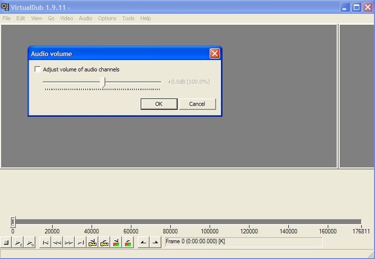

    hi thanks for your reply is this where you increase volume also where do i select codec
  4. Yes, adjust the volume there. Select an audio codec with Audio -> Compression... then configure it. Also select Video -> Direct Stream Copy to be sure the video isn't reencoded.

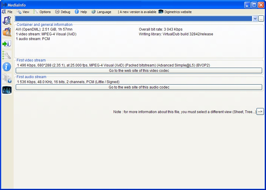

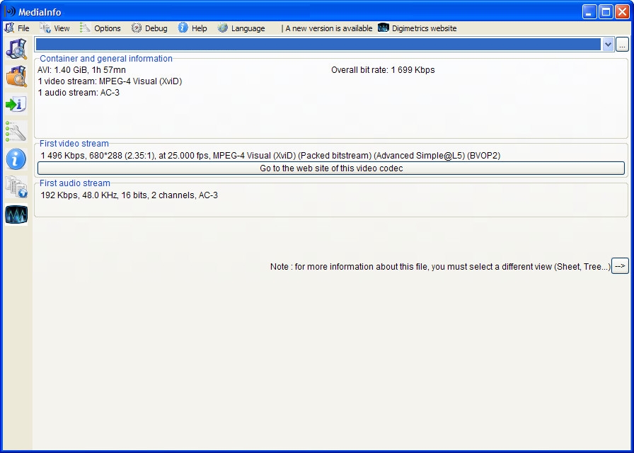

  10. This is the original video and as you can see its AC3 codec

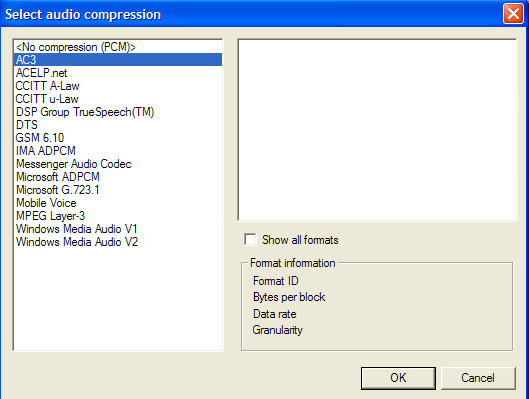

    I also selected AC3 in the audio in 3rd snap, but as you can see in the 2nd snap it says PCM so cant see what happened there also file is now much bigger

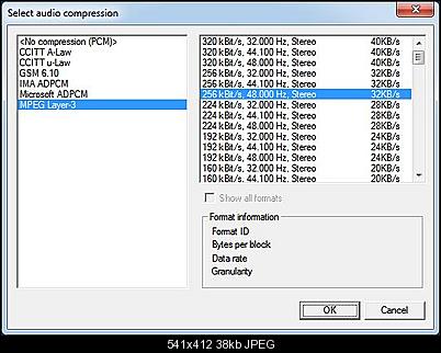

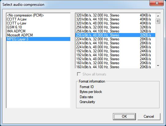

  11. The original video had 192 kbps AC3 audio. The file you created has uncompressed audio. That would be <No compression (PCM)> in that dialog. That's why your file grew so big. There are no parameters to choose from in the right pane of the dialog. That may mean the AC3 encoder isn't working (it may be a decoder only). Try MPEG Layer-3, MP3, instead. You should get a list of profiles to select from in the right pane:

    Aug 2003
    install the AC3 ACM Codec then you can use it in Vdub
