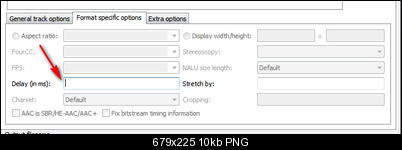

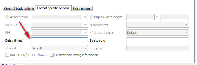

    you could try mkvmerge gui. open the mkv, uncheck the audio, add the mp4, uncheck the video. click on the mp4 audio, go to the bottom panel and adjust the delay. you might need to do it a few times to get the correct delay by trial and error.
