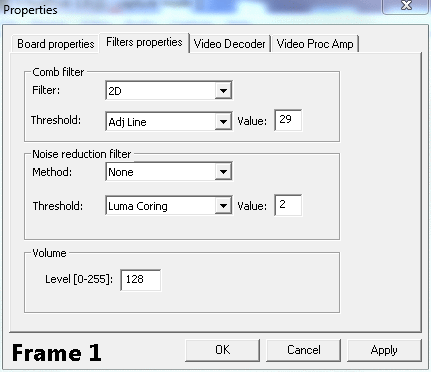

    I frankly did not see anything change in the picture using the 2D setting of the USB stick and turned it all off.
    Not sure what you mean here. There are bunch of settings ATI offers up but many are only applicable to other hardware that uses the same driver architecture. If you hit "Apply" you should see that only 2D can actually be set for this device.
    The laptop I was using does have a Radeon graphics card and I did see the options but it did not seem to affect the picture at all.
