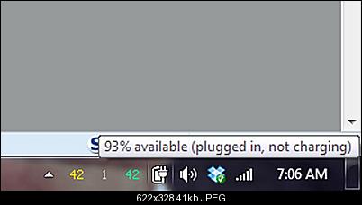

    From battery university:
    Li-ion cannot absorb overcharge, and when fully charged the charge current must be cut off. A continuous trickle charge would cause plating of metallic lithium, and this could compromise safety. To minimize stress, keep the lithium-ion battery at the 4.20V/cell peak voltage as short a time as possible.
    The laptop manufacturers know people's habits of leaving them plugged in all the time, and have designed them to allow this without damaging the battery.
    Modern laptops have threshold chargers for their internal batteries. They don't allow any current to flow into the battery unless its voltage is below the set point. This is very easy to design and implement, and all reputable brands utilize this type of voltage-limited charging. Owner's manuals don't always reflect this.
    For example, here's the little notice mine gives on-screen:
