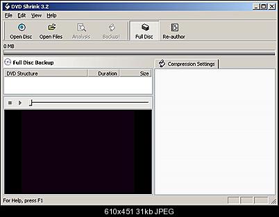

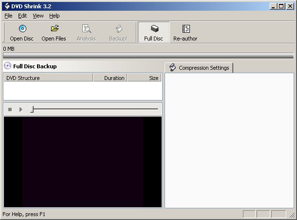

  1. If you've been adding images to posts by uploading them as attachments, try using the Images button in the menu above the reply box to insert them into the post instead.
    For some reason even images inserted in posts seem to sometimes show up as link attachments instead of images/thumbnails. I don't know if the forum supports showing bitmaps as images. Try editing your post and replacing the image with a jpg version to see if that works.
  2. Ok. The progress is I managed to get Irfanview to make an image. I have done the PrtScr before but it's not done often and so always seems strange.
    I'll try the images thing tomorrow.
  3. another test.
    saved the bmp (Windows BitMap) as jpg.
    Using Image icon on the quick reply....
    [Attachment 19170 - Click to enlarge]
    This seems to have accomplished the goal after quite a bit of todo. Perhaps a guide is needed just to do this much. Will see if the captured image remains after posting reply.
    IRFanview opens a window to allow changes in quality of the image and the file size is is 65kb using this procedure.
    I will review what I have for the dvd shrink reauthor guide and see if anythiong more is needed.
    IRFan view shows the image much larger than the image shown (actually it shows it too big) which is in this reply pretty much illegible.
    But this is a big step forward to know which element of the videohelp site software to effectively include images. Also upload tinme was very brief even on my limited bandwidth.
    What does the videohelp site need to change its dimensions.?
  4. Nope. The image displayed for me before sending but has not been captured to screen by the
    forum software. Admins take note.

    Since I'm in Full Reply, I'll try that jpg image once more:
  6. Image
    [Attachment 19189 - Click to enlarge]
    I wanted to respond to earlier inquiries about using Virtual Dub Mod to create two AVIs from one whole as in a first and second act. I have accomplished that task and managed to do it after encoding my audio jobs which involve using The Levelator to enhance spoken word.
    Above, Hello_hello made mention of doing this before encoding. What is the difference? I have not heard any perceived glitches where the cut was made.
    Since I'm using Full Reply, I'll try that jpg image once more:
    Nope, the "Insert Image" dialog box opened, I browsed to the image and nothing.
    On my preview it shows an html command (first line) to attach but that didn't find anything either.
  7. I'm not sure what's going on with inserting images in your posts. I've downloaded your image (the one which showed up as a link to an attachment) and I'll try to insert it here:
  8. Well the above worked for me..... I'm not sure why it doesn't for you, but it may be a forum glitch..... I click on the image icon, a little window opens, I browse to the image, select it, then click on "upload files" at the bottom of the little window.

  10. Originally Posted by hello_hello View Post
    (snip)
    Yes that's what I did-- when clicking on the image Icon, I browsed to the image, selected that, it uploads to Videohelp but it displayed as -- havene't got it on the screen-- but it displayed as another link to open rather displaying the image. The image had a name like dvdshrinktest.jpg or some such. There seemed to be an atachment 'instruction' included as text on that one rather than doing the command of 'display.'
    When you 'insert' is there a command for that and where is it? I think that might be the problem.
    I'll do it again here as I remember it....

    When you upload pics there's a button to click on to upload them after you've selected the pics using the file browser, but I assume you're using it given the pics are uploading, they're just not displaying properly. When I upload pics they appear as thumbnails in the posting area (where you type posts) as soon as they've finished uploading. I wonder if it's a browser issue? Which browser and version of said browser are you using?

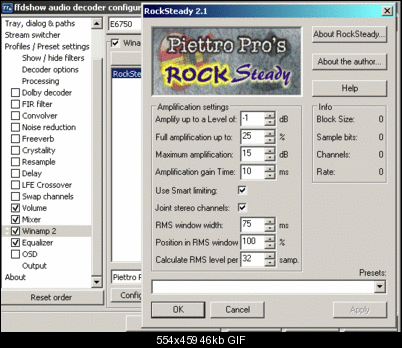

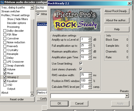

  17. Click image for larger version
    You'll see from the screenshot I also re-ordered some of ffdshow's filters because it seemed more logical when using the WinAmp plugin.
    The volume filter is first and set at -6db in order to give RockSteady some "turning up" heardroom. Well I do disable the volume filter on occasion if the audio is quieter than usual, but generally I just leave it. The -6db thing was just my idea. It may be clever, it may be completely silly....
    Mixer is the second filter because I use it to mix multichannel audio down to stereo and I've never bothered trying to work out if RockSteady can process multichannel audio.... so I give it stereo as that's all I want anyway.
    The WinAmp filter is third followed by the equaliser filter, which naturally isn't compulsory.
    The RockSteady Help file provides more information regarding which settings to fiddle with and what they do.
    "Full amplification up to" and "Maximum amplification"..... well they control the amplification.
