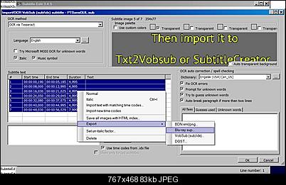

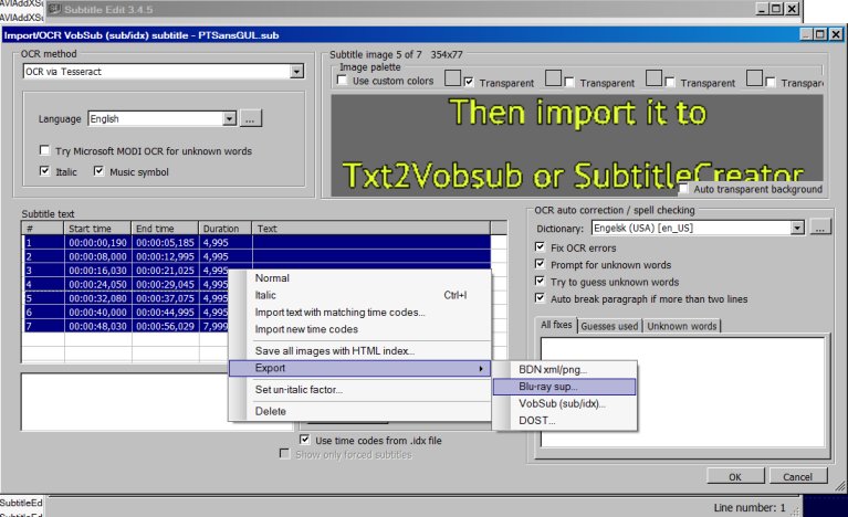

  11. I still do not understand how to make Bluray subs to DVD and reverse.
    For that you'll need BDSup2Sub (You can do it in Subtitle Edit. When you import an image based subtitle it'll open an OCR window. Selecting (mark) the subtitles you can right click and export)
