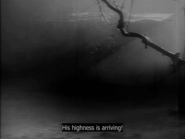

  6. SSA subs have a way to do it. Convert your SRTs to SSA (SubResynch is one way). Then open them in Notepad and in the Styles section near the top:
    [V4 Styles]
    Format: Name, Fontname, Fontsize, PrimaryColour, SecondaryColour, TertiaryColour, BackColour, Bold, Italic, BorderStyle, Outline, Shadow, Alignment, MarginL, MarginR, MarginV, AlphaLevel, Encoding
    Style: Style1,Tahoma,60,11842740,8421504,8421504,0,0,0,3,2,0,2,20,20,60,0,0
    Change the two numbers to be as shown in boldface. They're 'BorderStyle' and 'Outline'. SSA also allows you to configure the subs any way you like with font, size, colors, positioning, etc. They probably won't cover up all of those previous foreign subs though. Then load the SSA subs into the script using TextSub. To increase the size of the black box around the subs, increase the outline (change the '2' number to 20 or 40 or whatever you like).
