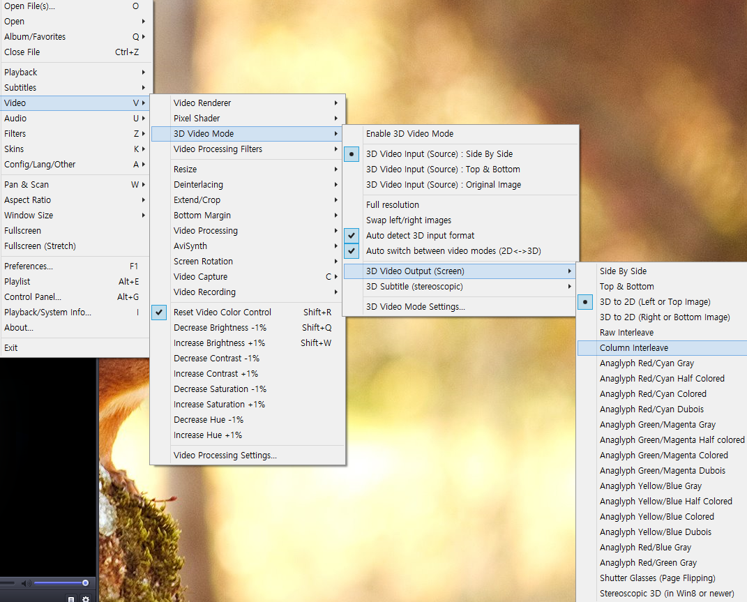

I am using PotPlayer with 3D enabled in Preferences. The system is PC connected to Full HD(1080p) LED monitor via HDMI cable. So, I think I am watching a 3D video in 2D. I am not sure if it works.
Not the right devices/hardware?
It's an MP4 file.Last edited by ConverterCrazy; 14th Jul 2014 at 23:43. Reason: Additional info added.
I Don't use potplayer, so not clear on what it's expecting. "3d enabled" could mean many things.
If you are trying to see a 3d clip AS 3d ON a 2d monitor, you don't have a lot of choices: anaglyph, old school field-sequential, parallel or crosseye freeview. All not such great quality.
That likely cannot be done using potplayer without avisynth assistance. (Except parallel, for obvious reasons).
If you are only trying to see the clip as 2d, try unchecking the "3d enabled" option. If that doesn't work, use a different player, such as Stereoscopic Player, or pipe the file through potplayer via avisynth, where the avisynth script crops & resizes one of the 2 halves. Or, do a crop+resize+convert to a new, regular 2d file.

Well, there is StereoMovieMaker & StereoMoviePlayer, both of which are free. But neither has been updated real recently (SMM-Feb2013, SMP-2010), and his apps always had weird programming restrictions (my guess is the programmer did it as a hobby and wasn't fully aware of all the complexities of VFW/Directshow video architecture & lean,clean programming in general - but I still liked his stuff, quite helpful on some levels). YMMV, particularly if you've got newer format files (AVC in MKV, etc).
Glad to help.
Scott -
@ConverterCrazy,
Not sure if you were aware of this: As per http://3dvision-blog.com/tag/potplayer-3d/, looks like you can do a realtime on-the-fly conversion of SbS to Anaglyph using PotPlayer!
Sounds more like what you were intending to do in the 1st place.
Scott -
http://www.dvbsupport.net/info/potplayer.html
Search "1.5.43738" in the page and you'll get some interesting information.
*Added the ability to auto detect 3D input format based on filename suffixes*
*Added the ability to auto switch between video modes (2D<>3D)*
There is more detailed explanation.
Sounds like SP is finally getting some open-source 3d capable player competition.
