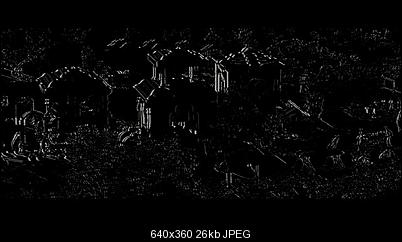

  4. After Subtract() and rectifying what you have is the amount of detail difference encoded as brightness. Try this simple script on a video:
    Subtract(last, Trim(last,1,0))
    Overlay(ColorYUV(off_y=-128), Invert().ColorYUV(off_y=-128), mode="add") #rectify
    It gives the difference between consecutive frames, not frames of two different videos. But you'll see that in still shots you get a black image. In moving shots you see lots of detail. During a panning shot (the two compared frames don't match) you get this:
    During still shots (the two compared frames match) the picture is totally black.
    If the videos are different sizes, brightness, alignment, etc. you just have to adjust the frames before subtracting. You have to do most of that to replace the logo anyway.

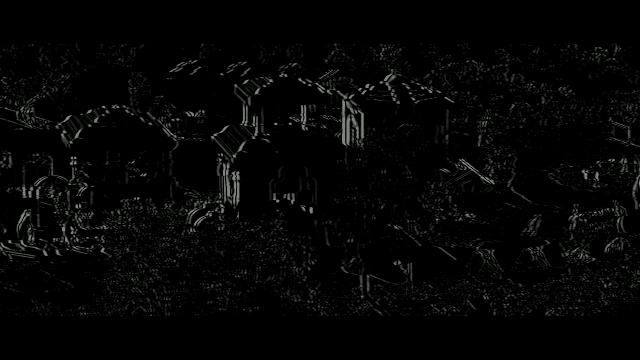

    BestLogoless = SelectBestmatch(LogoVid, Logoless1, Logoless2)
    BestLogoLess = SelectBestmatch(LogoVid, BestLogoless, Logoless3)
    BestLogoLess = SelectBestmatch(LogoVid, BestLogoless, Logoless4)
    BestLogoLess = SelectBestmatch(LogoVid, BestLogoless, Logoless5)
  29. Thanks but it was a post too late. It didn't work anyhow. Frames in the logo'd video must be dropped and duplicated to properly match the logoless.
  30. I'm not sure what your saying. But no amount of phase shifting will restore missing frames in your logoless video. And you may need backward shifts as well as forward shifts. You can use Loop(N,0,0) to insert copies of the first frame, shifting the rest of the video back.
