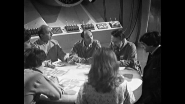

  3. Thanks poisondeathray:
    Here are two images - Regular (from the SD broadcast) and Stretched (from the HDTV broadcast).
Name:	Stretched (HDTV).jpg

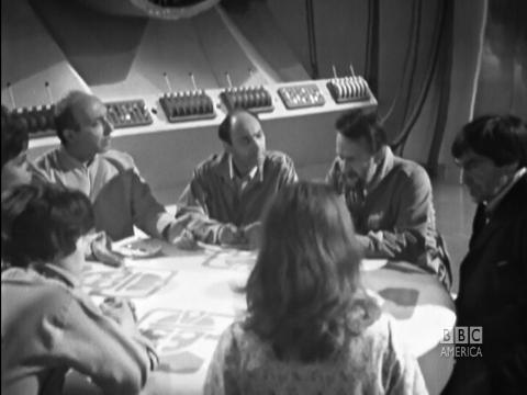

  4. Try WarpedResize() part of the SimpleResize package. This looks pretty close:
     WarpedResize(480,360, 1.1, 1.0)
    Adjust the third argument to get closer.

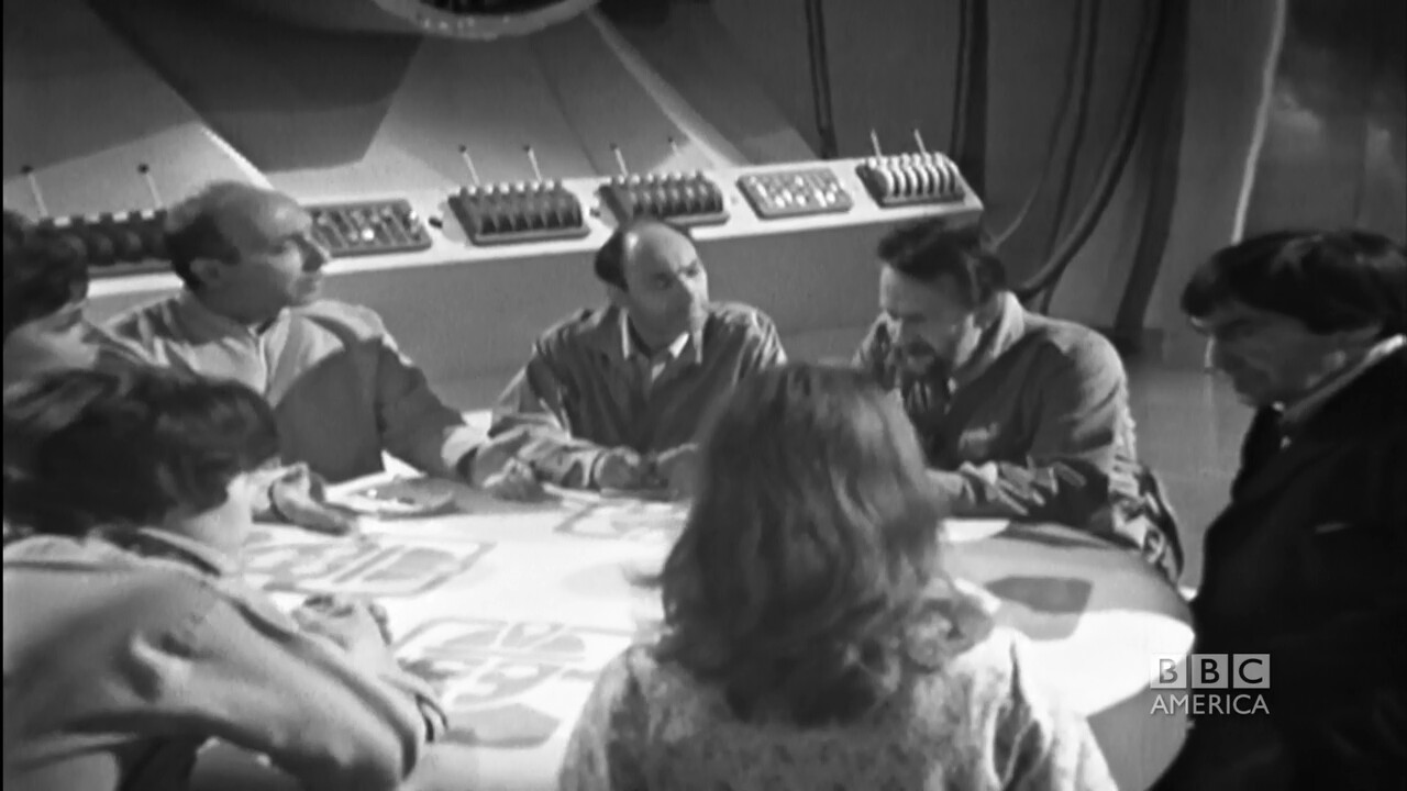

    The uploaded pics were reduced in size, and I was thinking the original is 1080p but its actually 720p (1280x720 - snapshot attached).
    How might that change the parameters?
  6. Wouldn't it be:
    WarpedResize(960,720, 1.1, 1.0)
    (he says, never having ruined a movie by using WarpedResize on it, or tried to undo the damage). You can add black to the sides, if you like, to bring it back to 1280x720. I'm surprised that the BBC, of all organizations, would wreck a movie like that.
