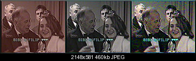

  3. That's what i get almost faint colored video
    thanks pois
    to bad the cameraman recorded in sephia some parts of the wedding video
    this is what i got so far

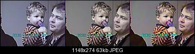

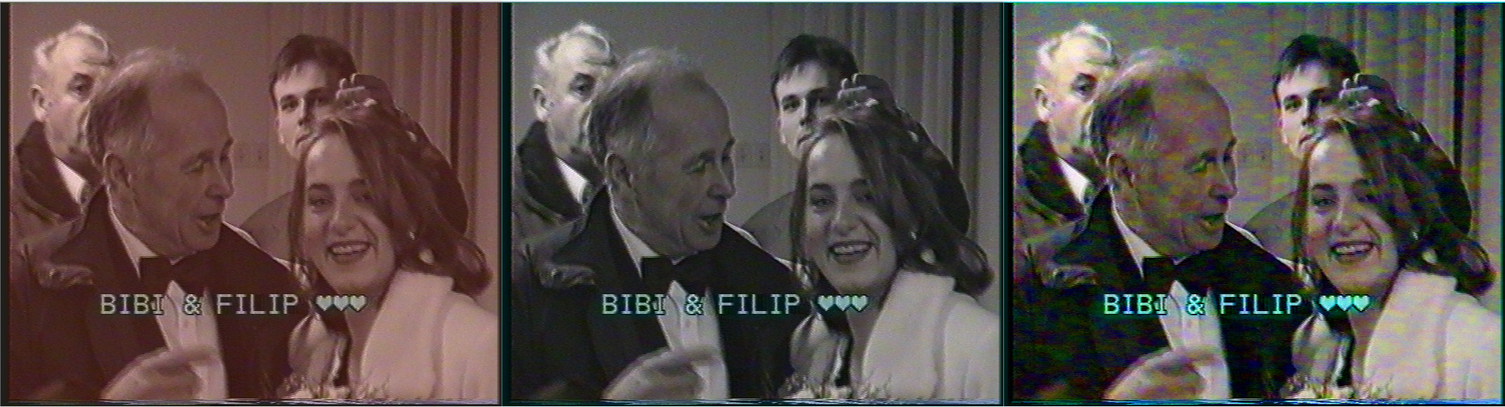

    Quick test in GIMP:
    (RGB Curves + Saturation boost + more RGB Curves)
    There is some colour present... but because it's at such a low level on the tape it's largely drowned out by chroma noise.
    AviSynth NR filters can probably come to the rescue here (I don't use it so someone else would have to advise).

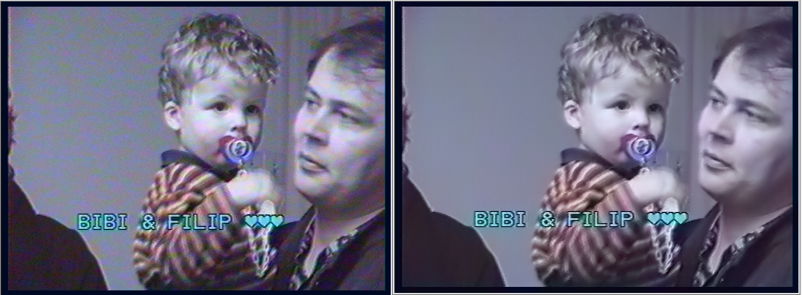

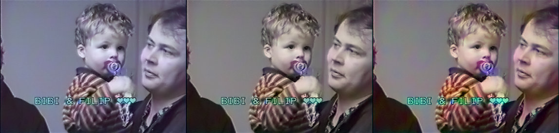

    The clips are pure unprocessed before the script. I used the jagabo suggestion ( i changed it a bit less colorization and contrast) and got something like this after color correction and denoise (first image).
    The second image saturated without nr and with nr
Name:	with and without.png

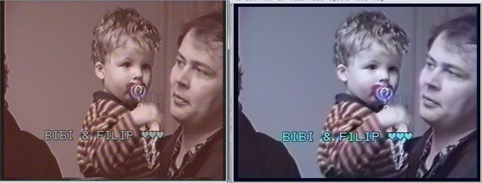

    Oct 2010
    England
    That looks promising.
    If you remove the blue tint you could bump up the saturation a bit further:
    The chroma noise is starting to reappear again though...

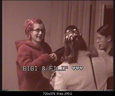

  13. Also note that one size doesn't fit all here, you'll have to go on a shot-by-shot basis. Some of your clips really have no useful color information -- it was shot under dim flourescents with an older camera.
  14. Originally Posted by smrpix View Post
    Which may be why it was converted to sepia tones.
  15. Originally Posted by jagabo View Post

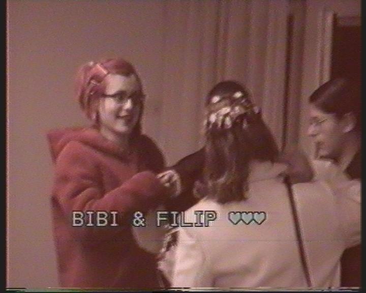

    That was my initial thought before seeing the clips and based on OP's question -- but now I'm inclined to think that was the best the camera could do, compensating for greenish flourescents. There's a few frames of a girl in red with red hair standing directly under a light in clip 1 which gave me second thoughts. As has been mentioned here earlier, camera sepia mode usually drops all color and adds a tint. --Not sure.
