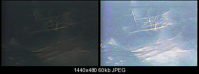

  1. There was a thread on here years ago that I can no longer find, but it addressed this issue. The poster had a Pioneer LD player but was getting essentially RGB like strips vertically down the picture. For some reason I think it had to do with the actual player itself (comb filter maybe?). I am working on a clip now from a Japanese laserdisc captured the usual way from the Pioneer LD into the datavideo 1000 tbc and then into the jvcdrm-100s dvd recorder deck
    I am getting this RGB type stripes, though faint in the picture below. Would I need a comb filter or is there some other option I can do on the PC side to either minimize or totally clear them up so I can restore the pic a bit
    the picture has two versions, one being the normal and the other really brightened just so you can see the noise a bit better
Name:	dr.butcher introcompare.jpg

    judging from the one pic you uploaded, i would say your laserdisc player is at fault. probably a warn (aged) laser. but i would try other composite leads, maybe another brand capture card.

    For OP: there is way too much macroblocking at the noise level in your capture to do any serious cleanup.
    What the heck is that a shot of, by the way?

    The sample pic was a shot of a field before it went to show a gravestone.

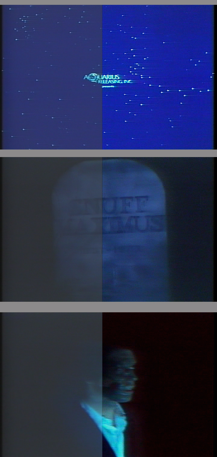

    I was able to clean it up to a minimal degree but nothing to write home about. It stills needs a lot of tweaking but I think I am going in the right direction. The enclosed pic will show you a raw and after (which is still messy). Ignore the usual interlacing, etc, I just want to get a feel to see what little I can accomplish. The real
Name:	dr compare 3all.jpg

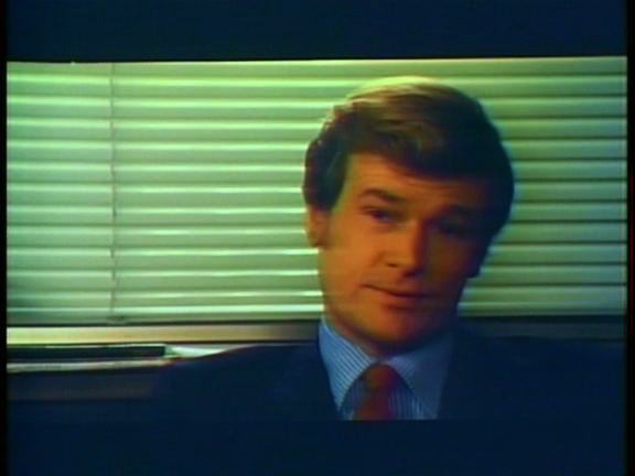

    Yes it was just that intro. The intro was from another (unreleased) film entirely. Below is a still shot from the regular film. It may be a bit brighter by a degree or two than the actual source video, but you can see it is nowhere as bad as the intro pic I uploaded (though the laser still has wishywashy colors but in 1989 I'm sure it would have been preferred to the vhs version)
