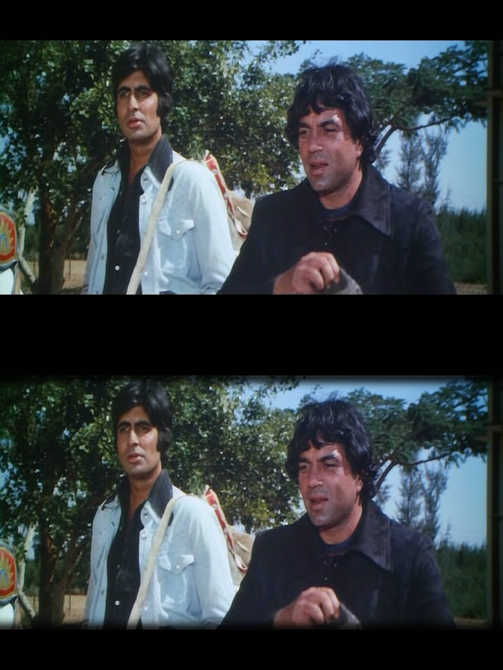

  2. You don't like black borders? I do. Is something like below what you had in mind?
    I'm trying to get that pro look where the border almost fades witth the movie.
    Have you ever seen any retail DVD where the borders fade into the movie? Or am I not understanding the look you want.

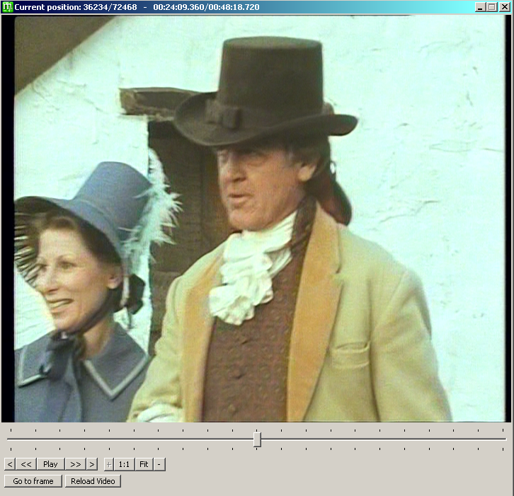

    I Think this is my problem :

    Are you talking about borders on the left/right? Doesn't the capture already have soft borders where the active picture ends?

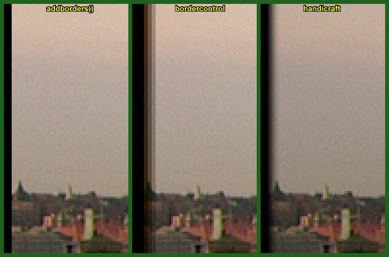

  14. Your screenshot is from didee's script (post 5&6) . You can copy&paste , just adjust the addborders values
    http://forum.doom9.org/showthread.php?t=141979
