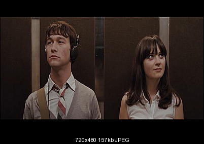

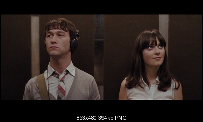

    I don't see these problems in TMT5. First shot from VLC. Second from TMT5. This is a dvd on the hard drive.
    TMT5's snapshot utility isn't particularly good though, and the picture seems stretched vertically. Not something I see in playback.
