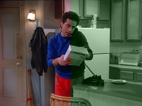

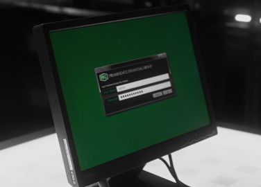

  5. To "literally" do what you say you want to do (convert non-green to greyscale while leaving green alone), you could try Tweak. Something like this:
    Tweak(sat=0, startHue=260, endHue=200)
    [Attachment 18160 - Click to enlarge]

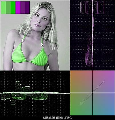

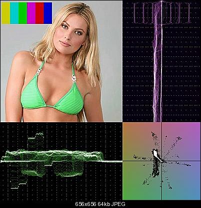

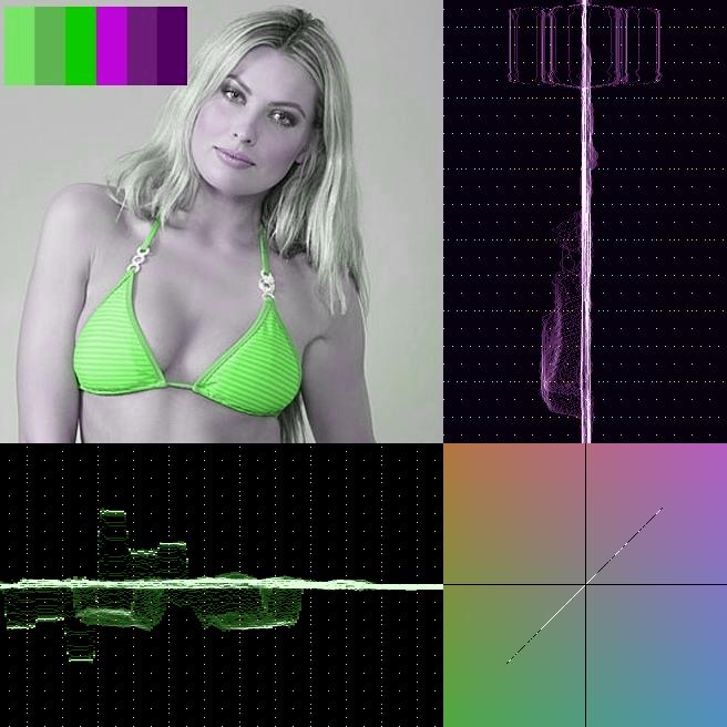

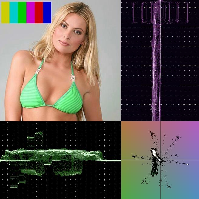

  26. The rotate(chroma), crush(U or V), unrorate(chroma) sequence basically works -- except the result has positive and "negative" hues. The negative hues need to be inverted.
    Original image:
    After Tweak(hue=-45).ColorYUV(cont_u=-256).Tweak(hue=45):
    As you can see, the problem is the end of the line in the UV plot that extends to the top left. It needs to be inverted to go to the bottom right, turning all the purples green. You can use different rotation angles to get different shades.
  27. Do want to limit the hue range (ie. a "narrow" hue range) , but keep S=saturation and V=value (brightness or lightness) the same as original ?
    Flatten the hue range but keep S and V as the original, yes.
    jagabo,
    Can you expound on your script? Why -45 hue then back? Why then increase the blue contrast (positive U is blue right?) by max?
    Also, how do you generate all those graphic analyses?
  28. The waveform and vectorscope graphs were made with VideoScope():
    VideoScope("both", true, "U", "V", "UV")
    At the right edge is the U waveform, at the bottom is the V waveform, at the lower right is the UV plot. On the UV plot, spots near the center are low saturation (grey), spots near the edges are highly saturated (much more so than the background color of the graph implies). A straight line drawn from the center of the graph to an edge is a line of constant hue with varying saturation.
    Tweak(hue=-45) rotates the colors -45 degrees. If you were to look at the UV plot at that point you would see a counter clockwise rotation of 45 degrees. This is in preparation for the next step.
    ColorYUV(cont_u=-256) reduces the contrast of U (eliminates the U saturation), reducing the UV plot to a vertical line from cyans to reds.
    Tweak(hue=45) rotates colors back to where they started. The UV plot is now a straight line from the lower left to the upper right. Anything that was predominantly green is now green. Anything that was predominantly blue or red is now purple. You can see this in the color bars. The yellow, cyan, and green bars have become green, all with the same hue. The purple, red, and blue bars have become purple, all with the same hue.
    This isn't the same thing as setting all hues of the original to a fixed value (even if you reflect the purples to greens). Some colors still lose saturation (flesh tones, for example). You can adjust for that by rotating by different angles). I believe the way round this is to add in colors rotated in the other directly and similarly crushed and working with squared values (think Pythagoras). But at this point it's probably easier to just write your own filter that sets a fixed hue. Convert YUV to HSV, fix H, convert HSV to YUV.

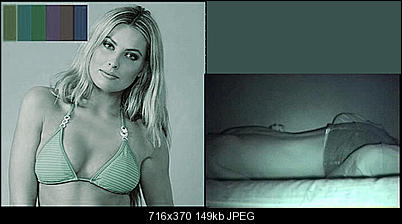

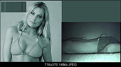

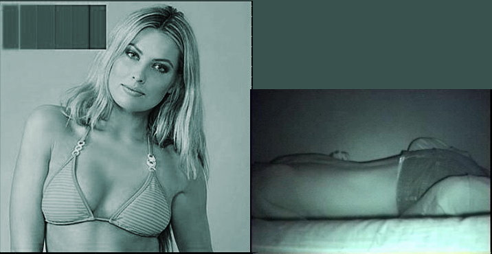

  29. Do either of these look like what you're trying to do?
  30. Originally Posted by smrpix View Post
    The first one is the right idea but I still see varying hue at the top of the screenshot.
    Btw, the pic of the hottie looks so depressing right now in that color. Looks like something out of Gothika.
