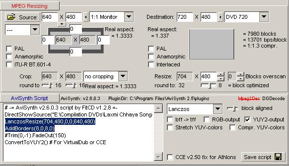

    Are you having a blonde moment? 640 is the width. You stretch the width to 720 (or 704, depending). You leave the height alone. No bars on top or bottom. After encoding as 4:3 it plays at the 'original' aspect ratio of 1.33:1. Just have a look at any resizer from 1:1 AVI/MP4/whatever to 720x480 for DVD. Maybe one such as FitCD:

    Should be 704 or 704 + black padding on either side as opposed to a resize to 720, technically... (as in your shot)

    NTSC DVD has ONLY 1 Full-quality/Full-resolution storage size: 720x480 (or, alternately 704x480, but it's basically the same thing)! That's it, end of story. If you want a full rez DVD-Video for NTSC-land, you MUST encode using that(those) resolution(s). If your source isn't that resolution, it will HAVE to be resized to match. If it was a 4:3 equivalent ratio (like 640x480), just stretch the horizontal, encode as 720x480, mark it as 4:3 DAR and you're done. If it was a 16:9 equivalent (like 852x480), just shrink the horizontal, encode as 720x480, mark it as 16:9 DAR and you're done. (Obviously, if your vertical is ALSO a different size than the examples, you want to do both proportionally to first get the vertical to the 480 height). But in ALL cases, the encoded & stored video is 720x480 (or 704), using 8/9 PAR (or 10/11) when expecting 4:3 DAR.
    And 640x480 itself is strictly NEVER LEGAL as a DVD-Video resolution, so you can't just somehow "keep it". Also note, that for DVD-Video, there is NO allowed setting that supports SQUARE PIXELS of any image resolution.
    @sanlyn, I agree that the vast majority of old H'wood films were Academy aperture AR (actually 1.375:1), though many Silents were exactly 1.33:1, but this has pretty much ALWAYS been adjusted to fit the 1.33 of the old television screens, so when transferring film-to-video, something was either cropped at that point, or there was a very slight horizontal squeezing. Clearly, the idea of adjusting a possibly "fluid" AR has been with us for a while.
    @santiam, if you took a 640x480 4:3DAR 1:1PAR video and encoded it to 720x480 4:3 DAR and it showed pillarbars, what you did wrong was lead the app to believe you wanted to MAINTAIN it's CURRENT PAR (which would put the 640x480 in a window within the 720x480 frame). Ironically, upon playback to your standard Non-square SD TVs, it would NOT maintain it's original AR, but look "skinny".
    Will it "lose quality" going from 640x480 to 720x480? Technically, yes, a little. But you have to do it anyway to make it DVD-Video LEGAL, as well as the fact that you'll be losing a little quality anyway because you're re-encoding from MP4 to MPEG2 (probably MORE because of that than the other). Just do it and stop worrying about it.

    Re-size and convert 640 x 480 to 720x480 using 8/9 PAR (or 704x480 using PAR 10/11) avi or mpg without adding any borders, and feed it into MPEG DVD Wizard.
