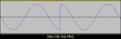

  8. Yes, you get clicks when there is a discontinuity in the waveform. For example the sudden transition in this sine wave:
    is heard as a loud click. The solution is to perform a cross fade or cut/paste to avoid such a transition.
