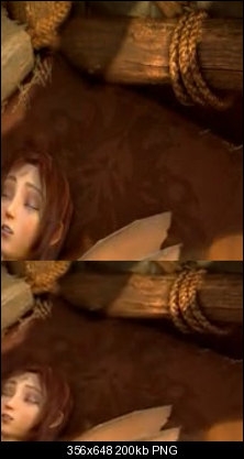

  13. Hech54's statement, though not well expressed, was that any time you compress with a lossy codec you will get some loss of quality. Here are 2x enlargements (point resize) of crops from frame 85 of your Sintel videos:
    As you can see the recompressed video (on the bottom) has lost lots of small and low contrast details. The brown pattern on the floor is messed up. The fine details on the wood are gone. Some caused by resizing, some caused by compression.

    [Attachment 18126 - Click to enlarge]

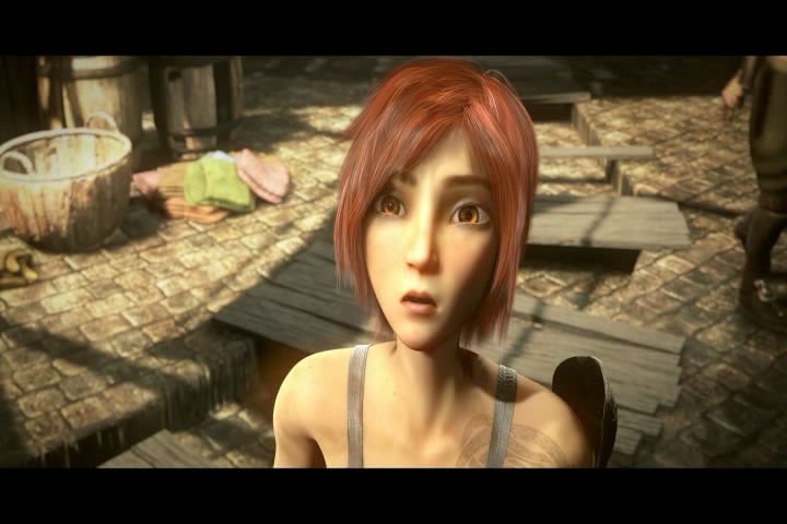

    This is final result when fix aspect ratio:
    If fix aspect ratio, then someone say you scale video, if not fix aspect ratio, then someone say your aspect ratio is false. Make happy all people is impossible.

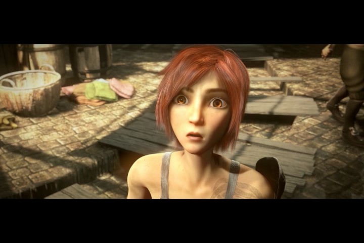

    Not if you do it correctly. This time you made it about 2.88:1. And it looks 1:1 to me, rather than 16:9. That's not how the image as stored on the NTSC DVD should look. It should probably look something like this:
