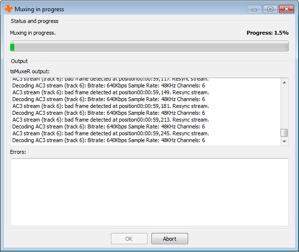

    When I muxed it all back together I never got any errors but I did get the following output (see attachment).
    When I play back the BD ISO I get no sound but the video plays up the point where I made my first cut and then the video stops.
    When I play the M2TS file from the BD ISO I get the sound from the second half that plays over the top of the first half video. That continues until I get to the first clip point and then the video and audio stop.
    Track 6 (referenced in the output - see attachment) is the TRUE-HD audio of the second clip.
    Can anyone shed some light on what might be going on? And how to fix it?

    May 2013
    Utah, USA
    Here is a capture from tsMuxer.

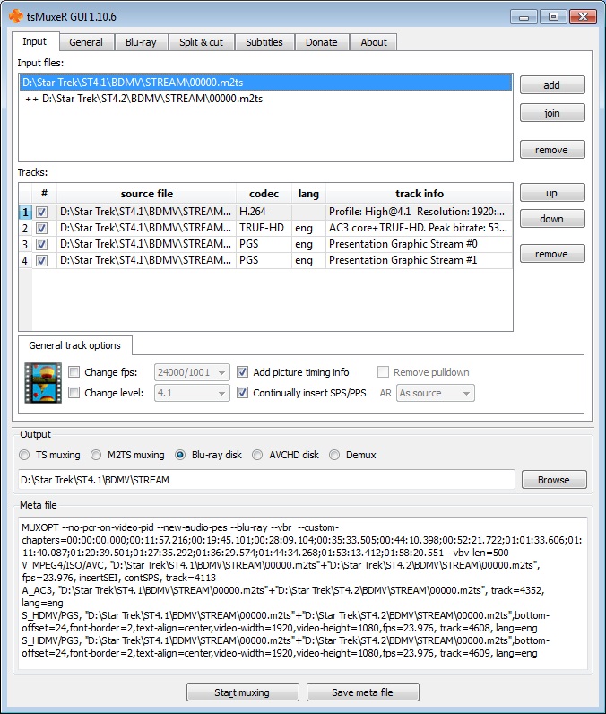

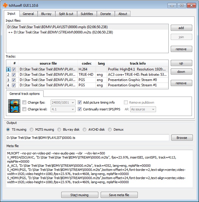

    12. Open the tsMuxer GUI, click the “Input” tab and then click the “add” button in the top right of the screen
    13. Navigate to the folder structure of the original movie (not the clips you just created)and find the playlist file in the BDMV/PLAYLIST folder, select the file and click Open
    14. Click the “Blu-ray” tab and copy the time stamps of the chapters
    15. Paste and save this data to a text document
    16. Click the “Input” tab and highlight the playlist file in the “Input Files:” window
    17. Click the “remove” button to the right
    18. Click the “add” button in the top right of the screen
    19. Navigate to the folder structure of the first clip you saved (in my case the part before the scene I wanted removed), click on the m2ts file in the BDMV/STREAM folder, and click Open
    20. Now click the “join” button (located below the “add” button in the top right of the screen)
    21. Navigate to the folder structure of the second clip you saved (in my case the part after the scene I wanted removed), click on the m2ts file in the BDMV/STREAM folder, and click Open
    22. Continue to add as many files as you have created
    23. Your tsMuxer window should look like the second attached image to this post
    24. Click on the “Blu-ray” tab and make sure the radio button next to the label “Custom chapter list” is selected
    25. Highlight and delete the timestamps in the window labeled “Chapters:”
    26. Open the text document for the chapter timestamps, edit them to reflect the portions you removed (this is not hard just take your time and do the math), copy the timestamps and paste them in the window in tsMuxer where you just deleted the timestamps
    27. Toward the bottom of the page click the radio button next to the label “Blu-ray disk” and then click the “Browse” button just to the right of the radio button
    28. Select the folder you want to save your files to and click OK - I recommend creating anew folder for this final version that has all the joined clips
    29. Click the button “Start muxing” at the bottom of the tsMuxer screen
    30. When tsMuxer is done close tsMuxer
    31. Using ImgBurn write the files to an ISO file
    32. You are done! Enjoy!
