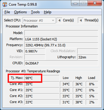

  11. CoreTemp will show you the max operating temperature for your CPU, Tj Max:
    That was my i5 2500K at idle. It goes up to about 55 degrees while encoding with x264.
    Note that CoreTemp reads the temperature sensors built into the CPU. Older CPUs don't have those sensors. They will have a temperature sensor placed under the CPU instead. You'll need another program to read those sensors. CPUID Hardware Monitor will show you a variety of temperature sensors in your computer (motherboard, hard drives, graphics card, etc.)
