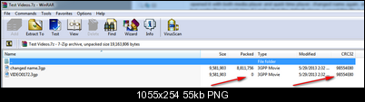

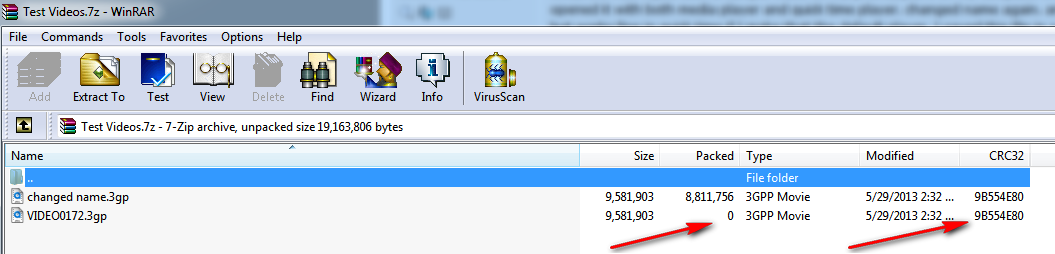

    What the hell. I just took a sample video on my phone, put it on my computer in another folder. changed the name, opened it with both media player and quick time player. changed name again. and it stopped working on media player but works fine in quick time if I make that the default player. I saved this file in a separate folder from the other corrupt ones. The others still wont play.
    I have attached both the original named VIDEO0172 and the one I have screwed around with. What is a corrupt filesystem and how do i fix it
  16. aBigMeanie aedipuss's Avatar
    Oct 2005
    666th portal
    both those files in the test vides 7z are exactly the same and both play fine here. winrar confirms it.

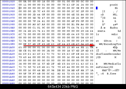

  17. aBigMeanie aedipuss's Avatar
    Oct 2005
    666th portal
    here's where the corrupt files go wrong. something has re-encoded them or re-written the headers to wm - "windows media". it's not in the videos that work.

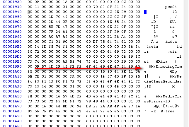

  21. aBigMeanie aedipuss's Avatar
    Oct 2005
    666th portal
    i tried just removing it, but it results in "bad public mov atom" - you'd need to find someone who knows how to re-write a mov atom(header) in hex.
