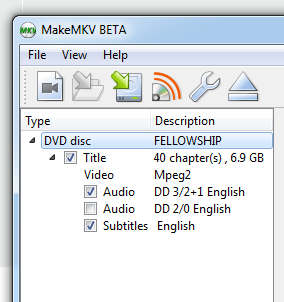

    I believe you can skip step 1 too. MakeMKV can decrypt DVDs, and allows you to choose what to keep:
