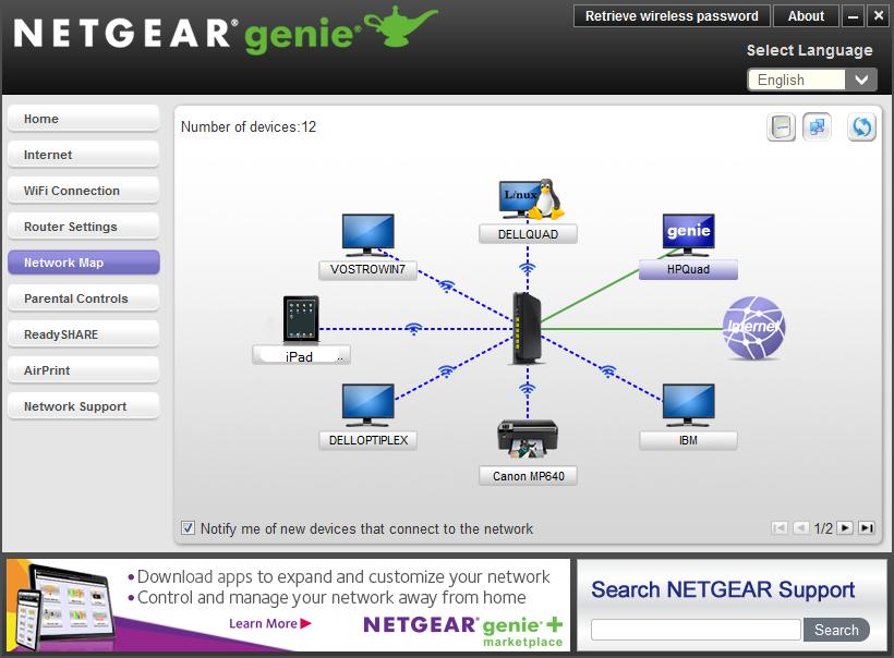

  12. Member p_l's Avatar
    Montreal, Canada
    If you're using the Netgear Genie in addition to the webpage controls, once you've identified your connected devices by their MAC addresses, you can rename them to something that identifies them more easily for you and also select what type of device each is, which gives it a distinctive icon.
