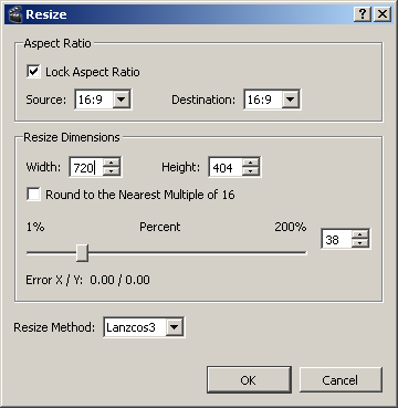

    I'm lost as to what best to enter into in the swsResize filter's settings.
    Shall I leave "Lock Aspect Ratio" checked, and correct Source (and Destination) to 16:9? (Both say "4:3" when the window opens.) Shall I set Resize Width/Height to 720x404?
    Please help, thank you very much!

    i'd leave your resize as listed in the first post. it should work fine. 23.976fps is ntsc just like 29.97 so it is the same size.
    Mar 2008
    Thank you very much, aedipuss!
    I'm quite surprised that my initial (and very uncertain) guess was a good one.

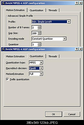

    I see Qpel8 options under "Macroblock decision" (which of these would you suggest I choose, please?):
    • None
    • DCT
    • Qpel16
    • Qpel8
    • Square
    (Thanks again, since during my last very different project I thought I recalled Qpel was appropriate.)

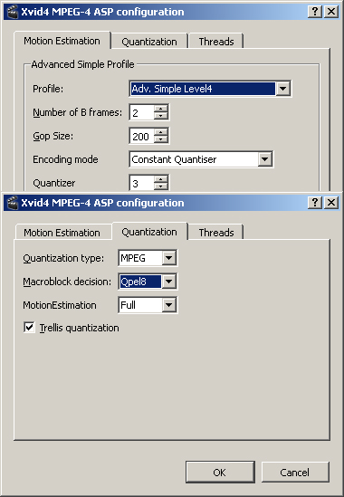

    I'm using XVID in Avidemux (where the xvid setting confuse me more than in VirtualDub). I'd really love any input on these two tabs, please:
    (As I noted previously, the "Macroblock decision" options are:
    • None
    • DCT
    • Qpel16
    • Qpel8
    • Square
  10. settings seems OK according to pics you posted here.
    some suggestions:
    Use H263 Quantization Type with Quantizer 4. Use MPEG Quantization for Quantizer lower than 4 . OK in your case.
    If you have BD player, Do Not downscale to SD, go for XViD-1080HD profile.
    Adv. Simple Level 4 is capable of 1920x1088. (H263+v2)
    If you go for XViD-1080HD, set Quantizer to 2.
    Convert AAC audio either to mp3 or AC3.
    Hope, no more doubts.
