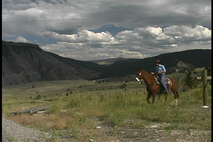

  7. Originally Posted by enim View Post
    it is possible that a encoded frame is partly interlaced and partly progressive?
    Yes. Where the encoder encounters comb artifacts it encodes as interlace. Where there are no comb artifacts it encodes as progerssive.
    Treating as BFF and trying yadif as suggested. but, if a encoded frame is partly interlaced and partly progressive mostly all deinterlace filters gonna mess around whole frame.
    Depends on the deinterlace filter. Smart ones only deinterlace where they see comb artifacts.
    Smart bobbed to 60 fps progressive (AR looks wrong to me, should be 4:3?):

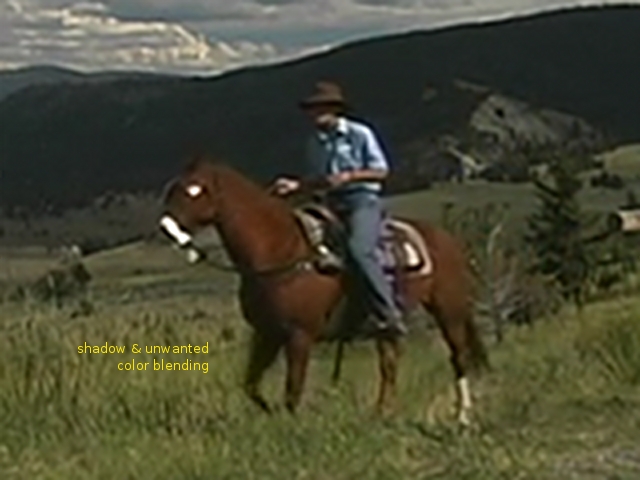

  8. aBigMeanie aedipuss's Avatar
    Oct 2005
    666th portal
    ouch nasty de-interlace. you lose parts of the objects in motion. like the horse is missing it's entire mouth area and parts of it's legs.

  9. as said, it looses details and sharpness.
    [Attachment 18055 - Click to enlarge]
  10. Yes, all deinterlacing is destructive. Some algorithms work better for some material, some for others.
    And, by the way, the horse's nose and legs were missing in that field of the original video too.

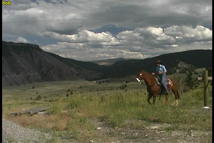

    bob:

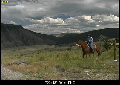

    And just for kicks, Yadif:

  11. Tks, bob seems better for this clip.
    and yadif is not too bad either.

  12. Originally Posted by enim View Post
    Bob generally produces the most buzzing edges (of the double frame rate deinterlaceres) and largest loss of resolution. It doesn't look too bad in that frame because there are hardly any near-horizontal lines and edges.
    If you zoom in you'll see lots of small dots where it made mistakes around the horse and rider. They aren't too visible at 60 fps though.
