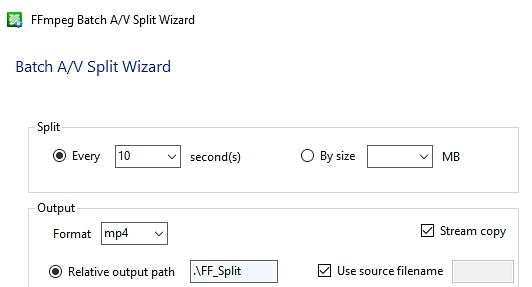

  18. Hello!
    FFmpeg Butch AV converter is a great tool.
    But I miss many functions which are good to work with in the console.
    Especially the function SPLITT is missing in parts!
    Split in time and size (MB) is available, but how can I split a directory with multiple videos e.g. into 6 parts???
    [Attachment 62376 - Click to enlarge]
    Also I miss the function to cut out a part of e.g. 1 minute from the video in the middle.
    With TRIM I can only cut the beginning and end, but how can I cut exactly from the time at the beginning a part of e.g. 1 minute after?
    Maybe someone can help.
    Nov 2017
    Madrid, Spain
    Hi, the trim feature allows to cut from specific time markers, for example from 00:01:00 to 00:02:00 for every file on the list. You need to uncheck "Start/end" below.
    The split feature cannot trim yet by specific numbre of chunks. I can't find a case in which this coul be useful, depending on source file size, output chunks will be of different sizes.
