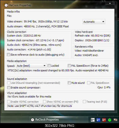

    Now, I have something weird going on. When I try to watch a 29.97 FPS video, ReClock shows this information:
    Why is it reaching ReClock with 59.94 FPS? This happens with every video at 29.97 FPS.
    I'm not sure about that one. I didn't have a 29.970 fps video handy, so I just remuxed a small 23.976 fps video at 29.970 for testing and ReClock saw it as 29.970.
