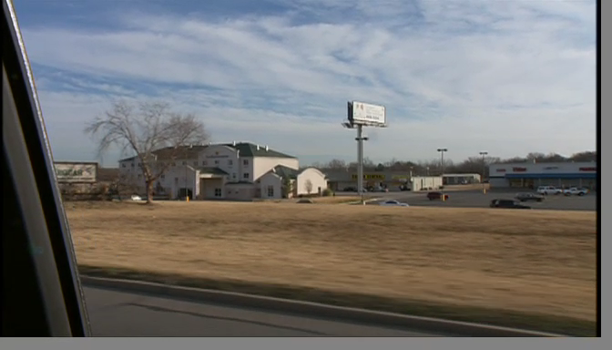

    I used Stream Transport to record an online video I couldnt otherwise get. The resulting FLV file looks/sounds great in VLC, but the picture is off center in Media Player (see image). Can I fix this?
    I wanted to repack the FLV into MKV, so I extracted the files and muxed with mkvtoolnix. I noticed the framerate changed 29.97 -> 30.303. Setting the framerate manually while muxing had no effect. Any ideas why this happened and if I should be concerned?
    Also, the picture (from the MKV) is of course still off center in Media Player.
Name:	offset video.png

  5. The problem isn't in stream transport, VirtualDub, AviDemux, the FLV file or the remuxed MKV file. The problem is the DirectShow h.264 decoder that's being used. It doesn't understand that the source has an active picture size (the part that's supposed to be displayed) smaller than the mod 16 frame size. VLC uses its own internal h.264 decoder so it's not a problem there.
