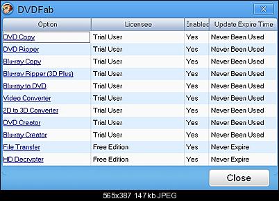

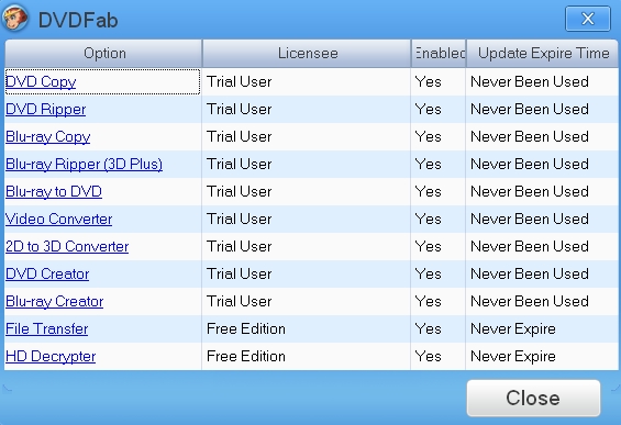

    Just downloaded the latest version and it shows up free - never expires for me:

    Here is yet another version buried deep on their website. It appears to be identical to my "Giveaway Of The Day" version from a long time ago and still has the old interface:
    http://www.dvdfab.com/mlink/download.php?g=DVDFAB
    I doubt it will decrypt anything NEW.....but I have nothing NEW to test it with. (version 8.2.2.8 - DVDFab8228Qt.exe)
    The latest version pictured above(DVDFab9040_avangate-675.exe) does default to "DVD Copy", not HD Decrypter and displays Trial Version. What happens after it expires(if it ever does) I have no idea. It might make the HD Decrypter option available again....who knows.
    My Giveaway Of The Day version came as a ZIP file(DVDFabDVDCopy_new.zip) and is dated 2011.

    ^Yes, when the trial expires for DVD Copy, you will have access to DVDFab HD Decrypter. Fab just likes to obscure the free section as much as possible. But it IS still there. jman98 is simply wrong about this.

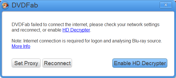

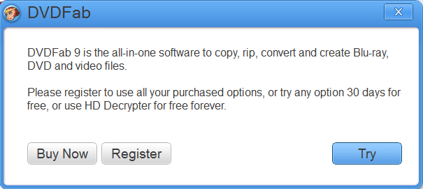

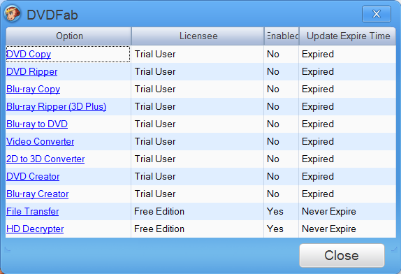

    Originally Posted by Steve(MS) View Post
    One of these later betas of Dvdfab that I tried to use on a couple of blu-rays, and I had denied it internet access, it defaulted to dvdfab decrypter
    and then wouldn't read the disc and displayed a "buy" it prompt box.
    It definitely wouldn't work without internet connection.
    Quite correct. DVDFab Decrypter stores your licences (if any) on their server and needs an Internet connection to validate. Whether you've bought or not, when no connection is available, the result is
    I.e. when unconnected you also can't decrypt Blu-Ray, even if you've paid.
    My unpaid installation appears as follows when connected, and I'm still happily decrypting DVDs
    and
    Hope this helps!
