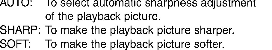

    On some devices halfway is off. Lower settings might blur. He'll have to experiment.
    cedricm says he has "some prosumer Panasonic SHVS decks" I have the PAL Panasonic NV-HS860 with separate TBC and 3D DNR. The sharpness settings on his may be different (if different models, and there are several good PAL ones), but mine are Sharp, Auto, and Soft. As near as I can tell the Soft setting doesn't actually soften the picture, but just doesn't add any crappy sharpening/edge enhancement. And that's why I suggested he just turn it off. LordSmurf is all the time harping on the default sharpening of the Panasonic VCRs, but maybe he's only seen the NTSC ones.

    The old Panasonic machines always used to say that the "EDIT" position was the "do nothing" setting for dubbing (it also disabled the variable sharpness slider) - but it doesn't always seem ideal for dubbing to PC, and the "newer" decks I have don't have that setting.
    I'm sure some of my camcorder tapes have oversharpening halos on the tape. Even at the softest setting on any deck, the halos are still there, but re-blurred!
    The OP has the sharpness way too high.
