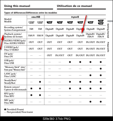

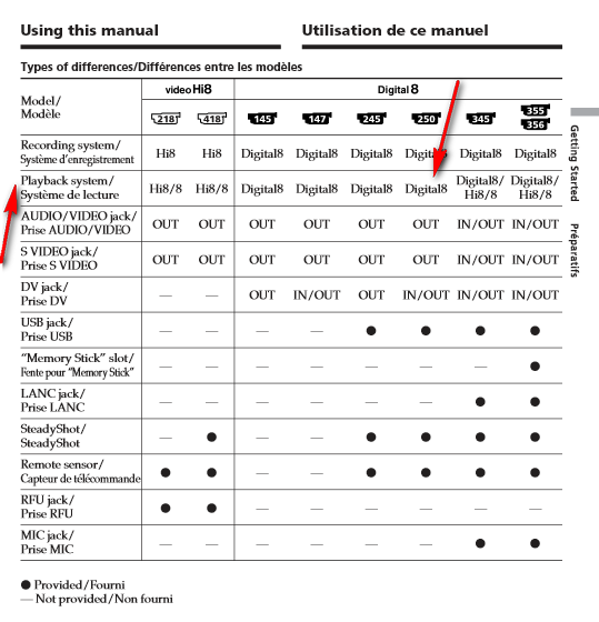

    well i'll through in a third opinion. this is from the sony website and shows the 250 does not support a8 or hi8 playback, only d8. you'd need a higher model sony d8 cam to play back analog tapes.

    I stand corrected then. I though all Sony Digital8 camcorders could play back analogue tapes. I've got an old TR7000E which was one of the very first D8 camcorders and I bought it because it could do just that.
    Oct 2005
    666th portal
    sony cheaped out on lower models and excluded helpful features like analog play and analog to digital passthrough.
