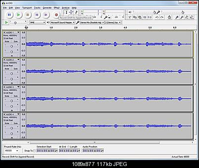

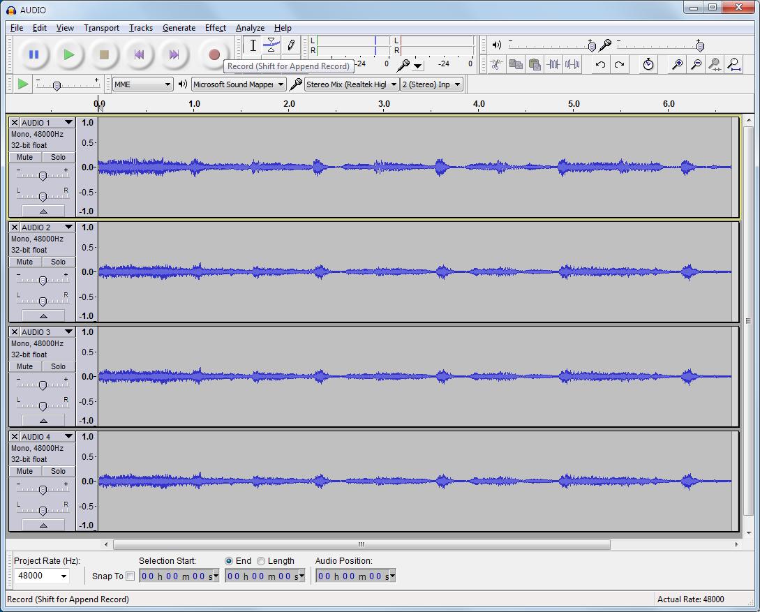

  9. Jeez, this would have been so much simpler in Audacity: File -> Import -> Audio (directly from the MXF file), delete the two unwanted tracks, Make Stereo Track, File -> Export (with desired container and codec).
    By the way, looking (and listening) in more detail, tracks 2, 3 and 4 are identical. Track 1 appears to be a normal "front" mono track, the other three just a phase delayed reverb channel. You don't really want to make that stereo. If anything, make track 1 into left and right front channels, track 2 into a rear channel(s), and delete tracks 3 and 4.

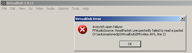

  11. Maybe I think have a problem:
    when I set the camera to record audio in 16bit mode, Avisynth don't read the .mxf files
    [FFAUer.bmp]
    when I set the camera to record audio in 24bit mode, Avisynth work ok
    On my dropbox [(www.dropbox.com) ad logon into it with this credential: user: mrocchini@email.it password: centrale forlder: "public" ] I put 2 file:
    AUDIO16bit.MXF
    and
    AUDIO24bit.MXF
    In virtualdub, Avisynth don't read the AUDIO16bit.MXF (I have rename audio16bit.mxf to temp.mxf)
    with this script:
    vid= ffvideosource("v:\automazioneclip\input\temp.mxf" )
    aud= ffaudiosource("v:\automazioneclip\input\temp.mxf" )
    left = GetChannel(aud, 1)
    right = GetChannel(aud, 2)
    both=mergechannels(left, right)
    audiodub(vid,both)
    ConvertAudioTo16Bit()
    meanwhile it's all ok with the 24bit one .
    Trying to remove the ConvertAudioTo16Bit() the problem remains.
    Anyone have idea to resolve?

  12. Audacity had no problems opening the audio from AUDIO16bit.MXF. Channels 1, 5, 6, 7, and 8 were silent. Channels 2, 3, and 4 had sound but were identical (not left/right pairs).
  13. Originally Posted by jagabo View Post
    yes jagabo, Audacity is a beautiful program but I have to batch-automatize the process so is necessary for me open the .mxf files in avisynth
  14. It's easier to batch automate ffmpeg or some CLI tool. Avisynth would require you to generate a script for each file, yes there are avisynth batch scripting tools, but CLI tools are to batch . But there is that problem with mixing with ffmpeg - it might better if you piped it to sox to do the mixing
    You can't batch automate anything if the track numbering is going to be different each time. 1,2 for the 1st, but 2,3,4 for the 2nd. If you mix the wrong track...
    I think ffms2 might be having problems because the 1st track is silent . You can open it with directshowsource() if you have lav filters installed and configured properly

  18. If you demux the audio from mxf, ffaudiosource() or wavesource() can read the demuxed audio ok
    eg.
    ffmpeg -i audio16bit.mxf -vn -acodec copy demuxed.wav
    This suggests the problem with ffaudiosource is with the mxf wrapper .
    Seems like too many steps to batch automate this process using avisynth
  19. This ffms2 build will open the audio16bit.mxf file natively
    http://forum.doom9.org/showthread.php?p=1607732#post1607732
    Note it's a CPlugin (not vanilla), but the .avsi will audio load it

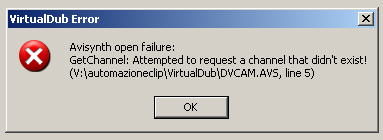

    I try to open with virtualdub/avisynth the C0025.MXF with this .avs script:
    vid= ffvideosource("v:\automazioneclip\input\C0025.mxf" )
    aud= ffaudiosource("v:\automazioneclip\input\C0025.mxf" )
    left = GetChannel(aud, 1).AmplifydB(0)
    right = GetChannel(aud, 2).AmplifydB(0)
    audiodub(vid,both)
    AmplifydB(0)
    SoundOut(output = "wav", filename="v:\automazioneclip\output\temp.wav", type=0, format=1, autoclose=true, showprogress=true, overwritefile="yes")
    but I get many error [dvcamer.jpg]
    In avisynth I have installed the ffms2-r725-icl-2 version
    At the moment I have no found on the web the R739 version
    Seems the FFMS can not read this dvcam-mode .mxf files
    Is there a way to resolve?
