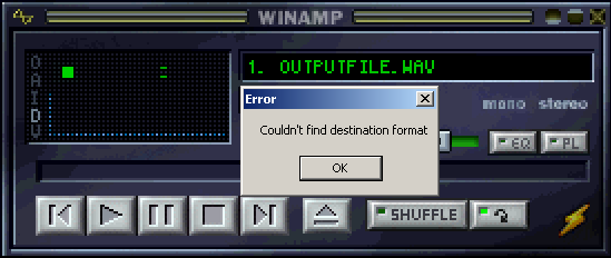

  10. SoundOut(output = "wav", filename="c:\outputFile.wav", atype=1
    Sorry but sometimes I'm a [pc.bmp]
    but with type=1 this is the results:
    [winamp.bmp]
    but maybe SoundOut is the solution

  11. a fast look at the documentation would have shown,... typo: atype=1 -> type=1
    congratulation you found it
