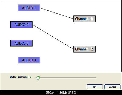

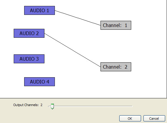

  9. The dropbox audio.mxf has 1 audio track, 4 channels . (ie. it's multiplexed into 1 wave)
    You can access each channel in audacity to do your own mix e.g. maybe you only want ch1 and ch2 to export stereo mix .
    File => export => advanced mixing options (output channels 2)

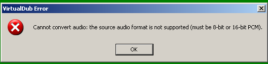

    With this script virtualdub open the AUDIO.MXF but when I try to Save WAV file I get this attach error:

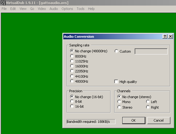

  23. Also I tryed to do this:
    In virtualdub-->Audio-->Conversion I set as attach [AUconv.bmp]
    and Save WAV file
    but my winamp don't read the ouputted .wav file because maybe is different than a PCM/48Khz files

  28. For the vdub error, add to the end of the script
    ConvertAudioTo16Bit()
