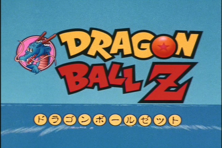

    And, I don't think there's any dot crawl on that particular sample. But here's a screenshot, that does show what I presumed as dot crawl. (around the letters of the title). I just presumed it was dot crawl, but after some reading realized I was wrong. So what exactly is that called?(just aliased edges...? Idk) In any case, that seems to be apparent quite a lot throughout the episodes, at random frames, which I would like to fix, if possible.
    And yeah, I know that grain is supposed to be there, but it's just a personal preference to have a smoother image I guess. I was reading up on spatial and temporal smoothers (Scintilla's Guide to AVISynth Postprocessing Filters) Though, I'm still not sure which one is best here, so yeah.

    And, I don't think there's any dot crawl on that particular sample. But here's a screenshot, that does show dot crawl (around the letters of the title). Correct me if I'm wrong, but that is dot crawl, right? Or am I using the wrong term here? (sorry if I am) In any case, that seems to be apparent quite a lot throughout the episodes, at random frames, which I would like to fix, if possible.
    That doesn't look like dot crawl; that's your method of chroma upsampling (conversion from YUV to RGB) with nearest neighbor algorithm
    (ie. It's your method of taking screenshots)

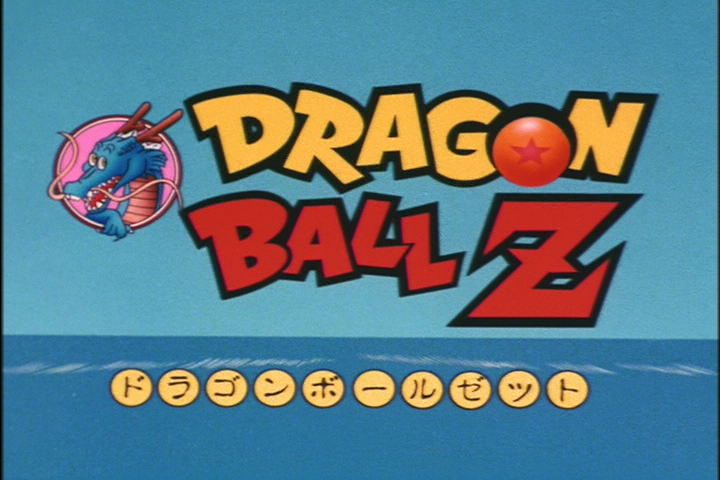

    Oh, yeah. Looks like you're right. Fixed it
    Thanks!
    Okay, so about the spatial/temporal smoothers. Which one suits this sort of grain? And how do you go about properly thickening the lines more?

    Grain - it's very subjective. One person's grain is another person's "noise" . You have to try some filters out and play with the strenghts and settings to see what YOU personally like
    Line thickeners - negative awarpsharp/awarpsharp2 values, some line darkeners have line thicken/thin values e.g. fastlinedarken/mod is normally set to thin (ie. some positive number). Set thinning=zero or negative value . There are other line darkeners you can try as well e.g. toon, hysteria, etc...

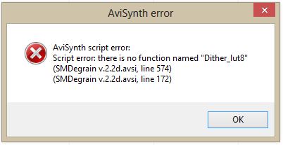

    Whenever I try using SMDegrain, I get this error (included screenshot)
    You need dither package ; see here
    http://forum.doom9.org/showthread.php?p=1386559

    Still getting the same error after installing.
  11. Do you have both the dither.dll and dither.avsi in the plugins folder ?
  12. Originally Posted by poisondeathray View Post
    Yeah, I tried putting the dither.avsi, and a series of errors came up, and I loaded each of the plugins it asked. And finally, no more errors came. Though the actual SMDegrain(lsb=true, thSAD=250, pel=4, subpixel=3, refinemotion=true, contrasharp=true, truemotion=false) filter didn't seem to do anything at all for some reason. It looked exactly the same, though the preview became unbearably slow (0.5fps) when I added the SMDegrain line.
