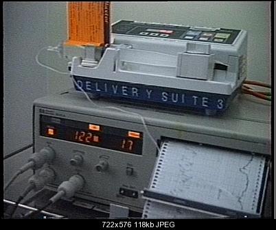

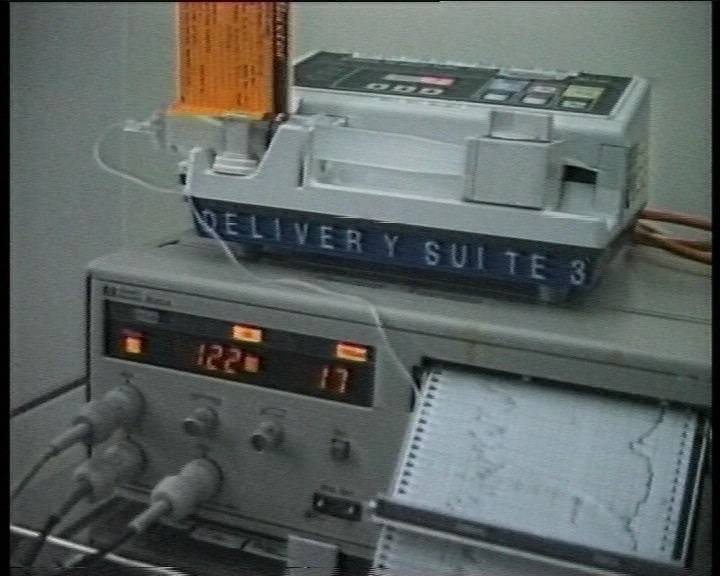

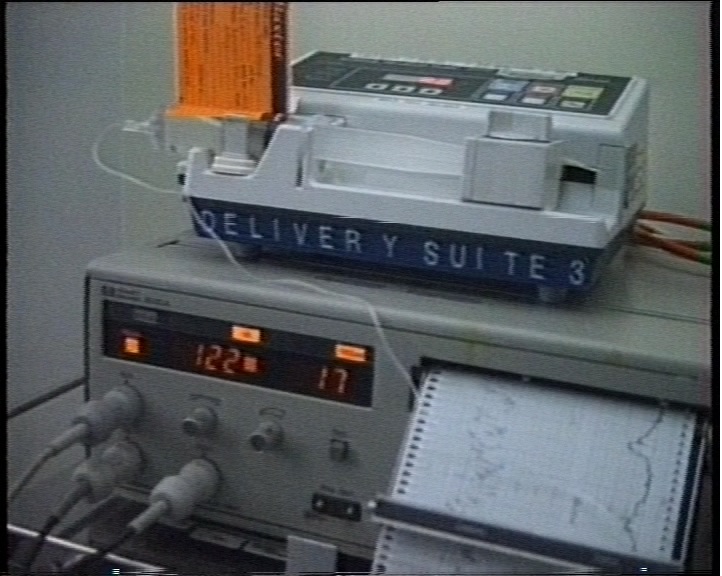

    Yes I am a little embarrassed to admit I forgot about the DIP switches - I set it up years ago, popped the DIP switch cover back on and it just sat on the shelf doing its thing until recently.
    As I capture through a time base corrector a bad spot of video makes no difference to me. Attached are the same analogue video 8 frames one captured by the DAC 100 (on the left) and another by a Sony D8 Camcorder (on the right). It is lowlight but you can see the D8 is more saturated than the DAC 100 - which I prefer and better matches the original video. In fact on very close examination of many frames I think the DAC 100 preserves more detail (and a bit more noise) than the D8 Camcorder.
    Tomorrow I will play with my DIP switch and post the result.
