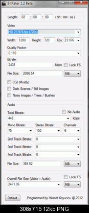

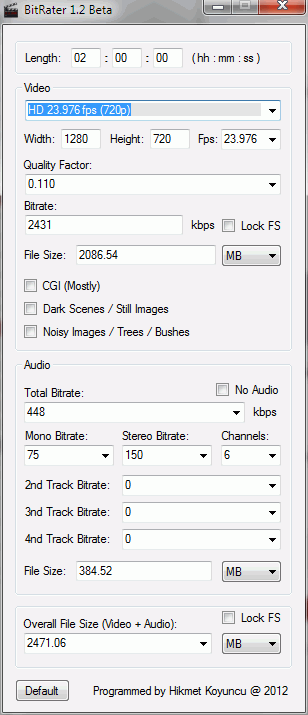

    Hello everyone.
    I write this tool for my video conversion works. I hope that is helpful.
    NET Framework 3.5 required.
    Beta 1.6: BitRater_1_2_Beta_6.zip

  4. Member DB83's Avatar
    Jul 2007
    Maybe I am mistaken but it comes over buggy to me.
    Change the quality factor and then follow that with the framerate amd bitrate/file size goes off the scale.
    May 2013
    Turkey
    If not enter video time, file size can not calculate...

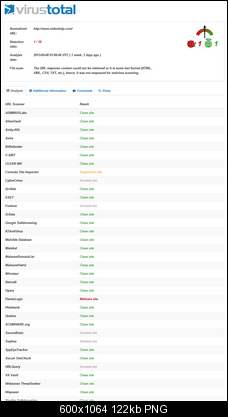

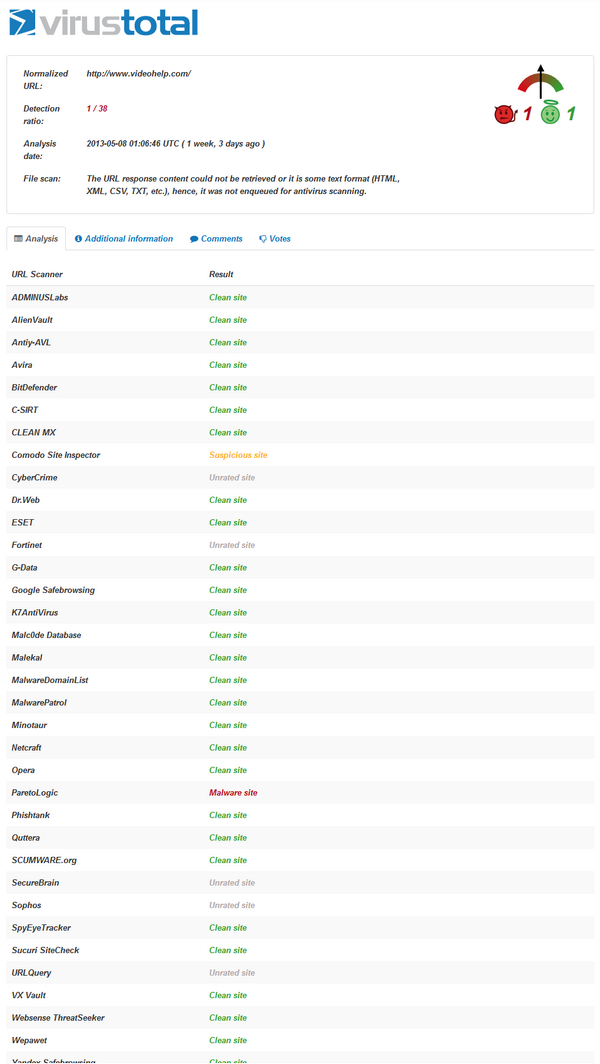

  10. aBigMeanie aedipuss's Avatar
    Oct 2005
    666th portal
    When releasing new software always use www.virustotal.com to scan it just to be sure,
    https://www.virustotal.com/en/file/2309f5669cac5d93b991fd609c001bfdd99459a09e28e4cd8e4...is/1368869041/
    https://www.virustotal.com/en/file/74e8bffdb6eda211e8245d6715147fee044ce1429f6fa30a996...is/1368869120/
    Your zip and exe are clean.
    I'm adding a mirror to this post also if it's okey. I might add it to our tools/software list later also.
    vcdhelp.com itself isn't coming up perfectly clean....

  25. I'm a MEGA Super Moderator Baldrick's Avatar
    [Attachment 17936 - Click to enlarge]
    I have removed the files that paretologic thinks are malware several YEARS ago but they are still active, http://www.malwareblacklist.com/searchClearingHouse.php?search=videohelp.com
    http://www.malwareblacklist.com/searchClearingHouse.php?search=forum.videohelp.com
    And lots of software aren't perfectly cleaned as some antivirus thinks that everything is malware or suspicous.
    But back to topic now.
