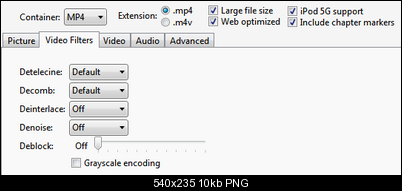

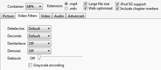

    get rid of the variable framerate. there is a box to check for constant framerate. and have the video filters set like this.

  5. If the original was a sports broadcast, it's likely interlaced - then you would need to set it to bob deinterlace to keep the motion smoothness
    I think newer handbrake/vidcoder and nightly builds have this option now
