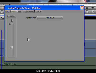

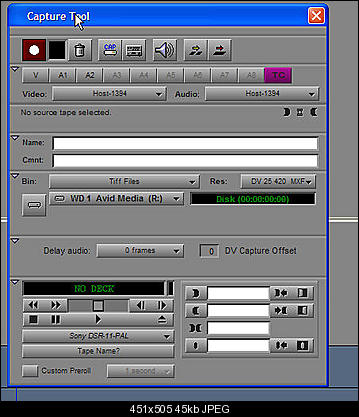

    This is as good as it gets as far as Audio input goes ( it's expecting Host-1394 ) i.e firewire
    you can get audio in via mojo or Liquid or even through the sound card ( MIC input ) but this is the way Avid expects to see S&V .. this being the first image, the audio end which you can also toggle to select the MIC input - the other image being S&V combined digitized DV material in my case. you can also import S&V via a P2 card its a very comprehensive bit of kit.
Name:	Audio via FW.jpg
ID:	17915Click image for larger version

    Does this capture tool invoke playback of the dvr like pressing that play button on the lower left ?
    There have been several issues reported lately with WinDV and using that to invoke playback. The solution was always to invoke playback from the unit and not from the capture program.
    Beyond that.........
  25. Member
    May 2013

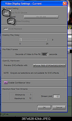

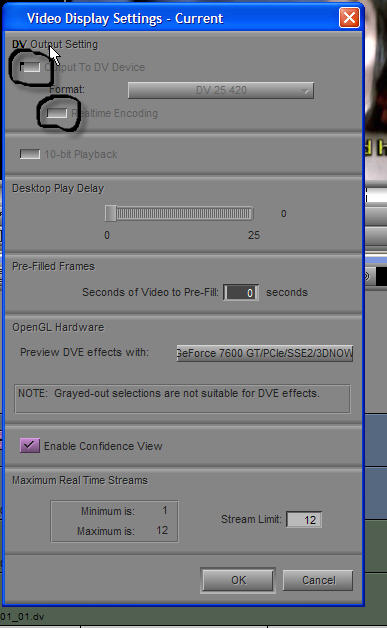

    The image below I have circled the buttons that become live once a recognised deck appears, ( my Sony DSR-11) the capture tool will invoke playback in fact all functioning buttons of the capture tool - it does however recognise the DVR as a deck ( I use a generic deck template )
    You can not however control the DVR from the capture tool ... what then has to happen is that you have to put the capture tool into a free running state and then control the DVR with its own remote or from it's front panel - then capture ( red record button top left capture tool manually ) and then play the DVR disc ... that's what I was hoping would work
  26. Member DB83's Avatar
    Jul 2007
    I do not think that last screen has anything to do with capture. IMHO you have been quite fortunate in pursuading the program to output to this unit - something that is not exactly officially supported.
    With that in mind, and given that the unit is primarilly designed for camcorders (as far as DV support goes), to fully reverse the process appears to be 'pushing the envelope'
    If you do eventually get it to work with this software then do come back and let me know. But for now I think I have hit a brick-wall.

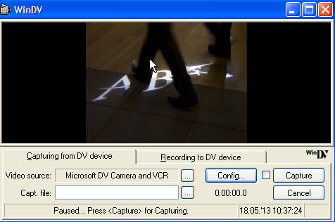

    I should own up to the fact that I really did not appreciate what WinDV actually did - I looked at it very late in our post exchange - and it looks like it is absolutely lossless which is a real bonus.
    If I ever solve this I will certainly post it here .. you know what it's like when you see a "dog with a bone" you just keep going in the forlorn hope that you think you can fix it.
    But it does though seem that in my case WinDV is the best route to take, again thanks very much for asking the question @ 17th May 2013 11:36
