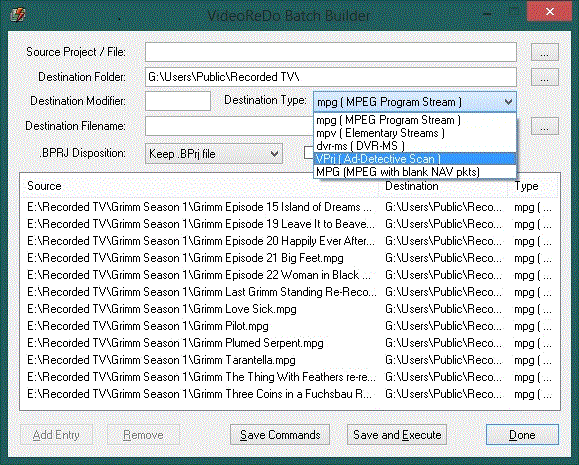

    However, I see when "Start Batch Manager" is selected from the Tools menu, the window that appears is titled "Batch Builder". ...or do you mean you don't see the option to create "Vprj (Ad Detective Scan)" as the "Destination Type"? Below is a picture of the dialog window.
    According to VRD's Help file, using "Vprj (Ad Detective Scan)" as the "Destination Type" is supposed to perform ad detective scanning for all the media files in the Source List and creates a Vprj project file containing the cut list to remove ads for each of the media files scanned. Running those Vprj project files within "Batch Builder" with one of the media file types as the "Destination Type" should perform the actual editing.
