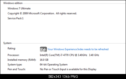

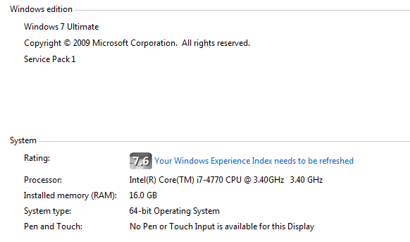

    All videos and video players are working without any error just (VLC) Because i like it . and I used it from a long time
    me system is Click image for larger version
ID:	28723 Name:  Capture2.PNG
Size:  4.7 KB Name:  Capture3.PNG
    Is there a solution or I have to use another program
