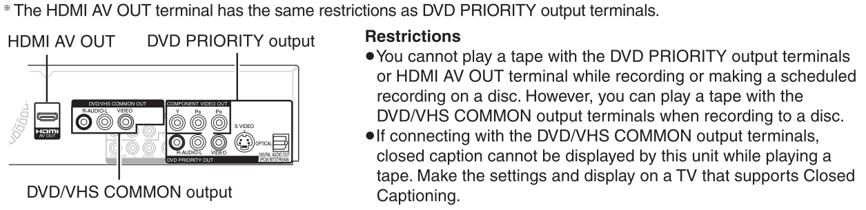

    jagabo, check this out from the manual for the DVD recorder:
    Heavy implication that the S-Video and component outputs are just an A-D-A process of the signal.

  17. Originally Posted by vaporeon800 View Post
    [Attachment 17824 - Click to enlarge]
    Yes, I agree that's likely. Especially having seen the later caps.

  19. Formerly 'vaporeon800' Brad's Avatar
    Apr 2001
    Vancouver, Canada
    In fact I can't think of any other way besides A-D-A that the S-Video output would have added black borders compared to the composite.
