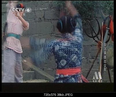

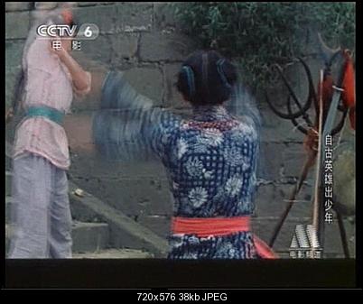

    I have a DVD made from a TV recording in China. The picture quality is not too bad, except for when people move quickly. lol! Here are some screen caps:
    I am dying to see this movie look better than this. I have some experience with virtual dub, and very little experience with avisynth. I mostly work in adobe for my video editing/improvement needs. I am here to solicit help of the gurus here, and pay for your help. I would be happy to upload the film in your preferred format, and will pay to learn how to fix this kind of thing (if it is indeed fixable). I am also happy to pay a guru to fix this for me. Please send me a message stating your terms, and lets see if we can get this fixed up.

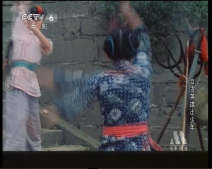

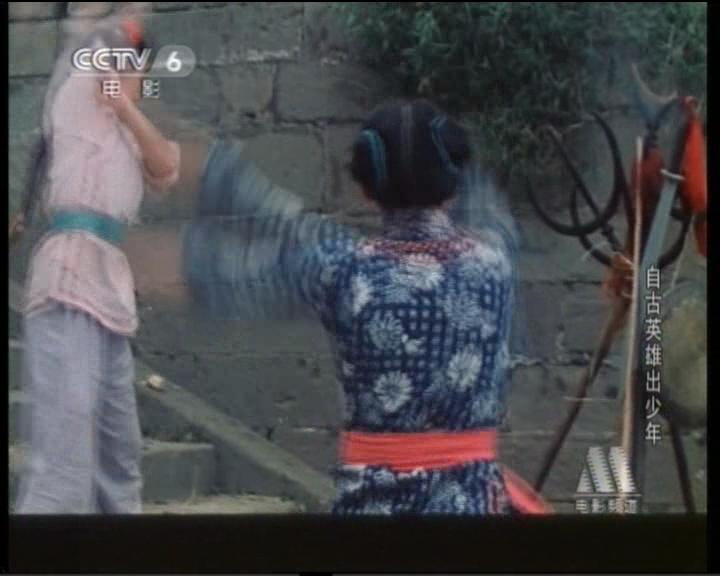

  7. That's an unfortunate conversion. Someone ran a blend deinterlace on a progressive PAL video with a field shift. I don't think there's any filter that can fix that. In fact, I don't think it's possible. I'll try a few experiments though. Probably tomorrow.

    Just curious to know if you had a chance to look at the clip. How could you tell that someone ran a blend deinterlace on the video?
    Every frame is a blend of two images. If you look at any two consecutive frames (where there's motion) you'll see that one of the blends is the same in both frames. For example, if one video frame is a blend of the original film frames 3 and 4; the next video frame is a blend of 4 and 5; the next a blend of 5 and 6. There is no way to remove this type of blending.
    For example, here are two consecutive frames:

    The arm of the woman in the foreground is horizontal in both of them. One frame is mixed with the film frame before (with the arm raised) and the other is mixed with the film frame after (with the arm lowered).

    So how do you avoid this in the future? I have never seen this in ten years as a videologist.
