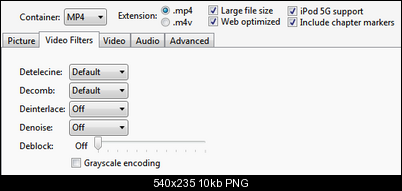

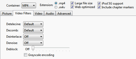

    vidcoder should be set this way.
    the blockiness could be from too low a bitrate. try setting the cq around 18

  5. aBigMeanie aedipuss's Avatar
    Oct 2005
    666th portal
    with the settings as shown, it still does a form of de-interlacing using yadif if needed.
