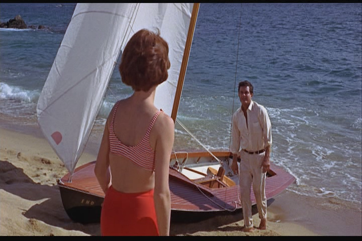

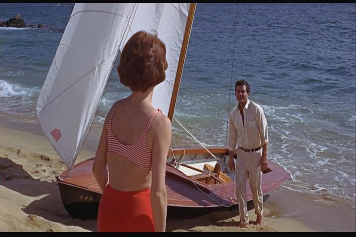

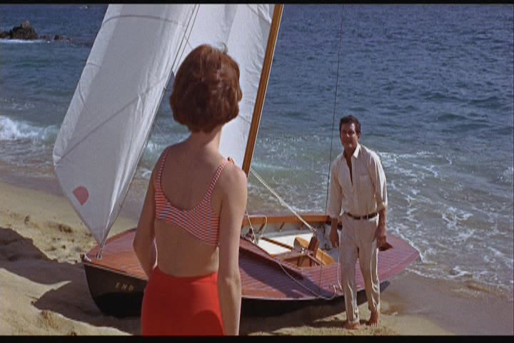

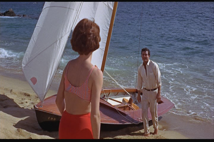

  1. It seems that the red striped vest the girl wear has some stranged artifact.
    The first shot is strange, but the second one return to normal. These two shots were taken within a few seconds.
    I've got no idea how to deal with it.
    Screenshot was taken from the attach video clip which gave a more straightforward sight.
    Wishing someone could help me out.

    I would say it's not moiré and instead point to the MPEG-2 encoder as the culprit. If you step through the video at PAR you will see smooth wave-like distortions.

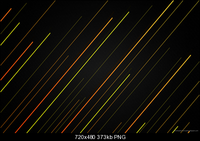

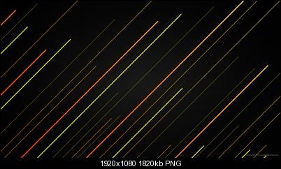

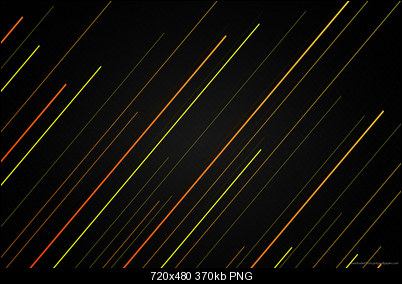

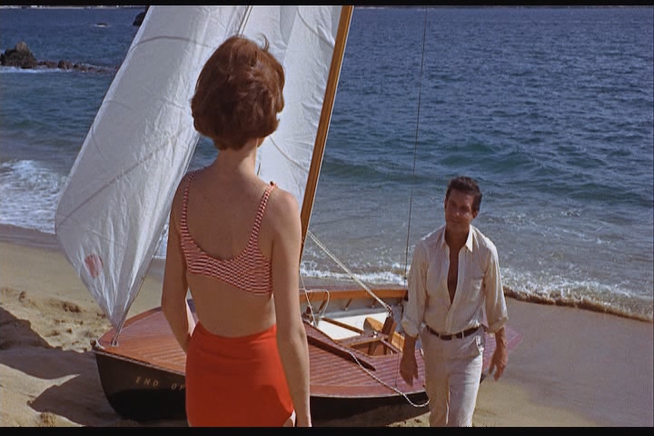

    Frame 0: Image
    [Attachment 17771 - Click to enlarge]
    Frame 0 bob: Image
    [Attachment 17772 - Click to enlarge]
    Frame 0 TDeint: Image
    [Attachment 17770 - Click to enlarge]
    Frame 1: Image
    [Attachment 17773 - Click to enlarge]
    Show me an example of poorly deinterlaced 1080i being visible in a 480p downscale.
ID:	17776Click image for larger version
ID:	17774Click image for larger version
