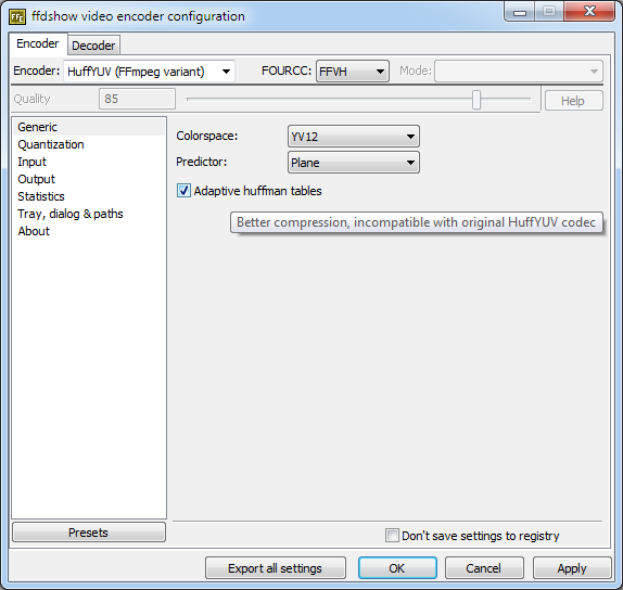

    I tried more than 6 video files with 10min length. When I enabled the "adaptive huffman tables" option in Huffyuv, the size of the videos veree the same as the videos which were compressed by UTI video codec. Both encoder USED the YUV 4:2:0 color spaces.
    What version of HuffYUV you have? Mine is the "CCE-patched" one, and definitely it does not show any "adaptive Huffman tables" in the configuration applet.
    Also, the UT codec let's you choose between "optimize for compression ratio" and "optimize for decoding speed".
    See the FFDSHOW encoder panel, which was posted in my previous message.
    I Used the better comression option in UTI, but UTI couldn't produce lesser file-size than Hufyuv with the usage of "Adaptive Huffman Tablets" option. Also Huffyuv has shorter encoding time than UTI codec. The Huffyuv decoding used less CPU power, than the decoding with UTI compressor
  12. The picture shows he's using ffshow's Huffyuv encoder, a variant of Huffyuv.
