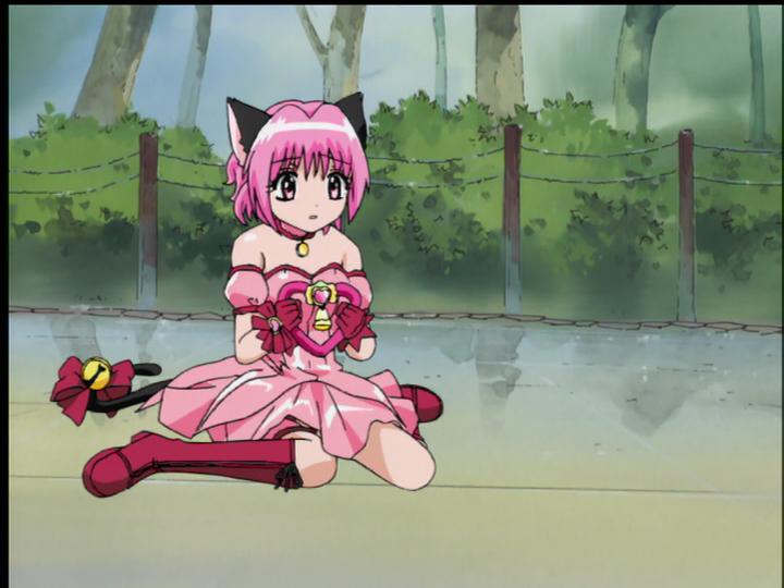

  4. I'm working with this crappy dvd source now, and there seems to be a problem. If you look closely at the boots in this screenshot and other areas you see a bluish color mixed in. Is there a way to get rid of this?

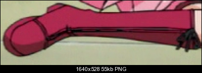

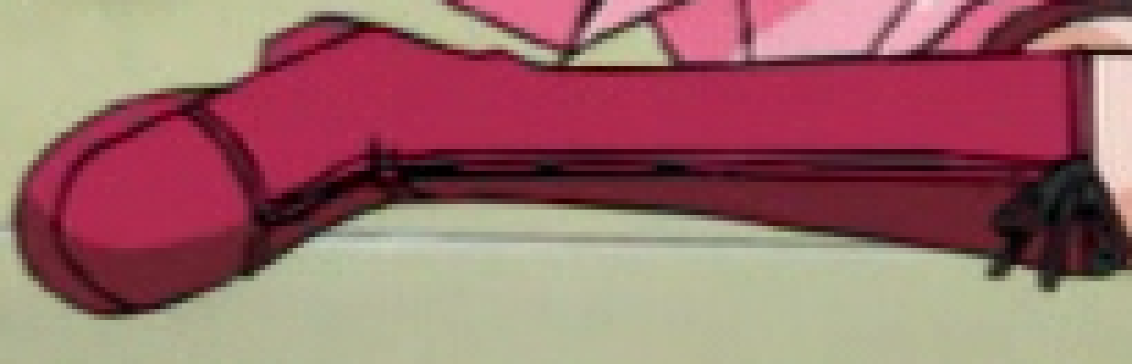

  11. I don't see anything blue:

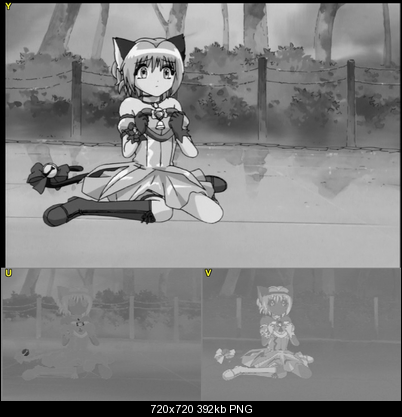

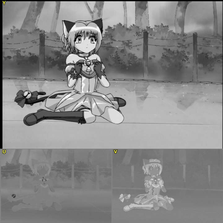

    Just the greyish brown spots that are probably from YV12 chroma subsampling. Do you realize that YV12 video has colors at 1/2 resolution (each dimension) of the greyscale image? A 720x480 YV12 image has a 720x480 greyscale plane and two 360x240 chroma planes:
    So small colored patches and sharp edges will always get discolored.
