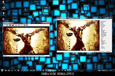

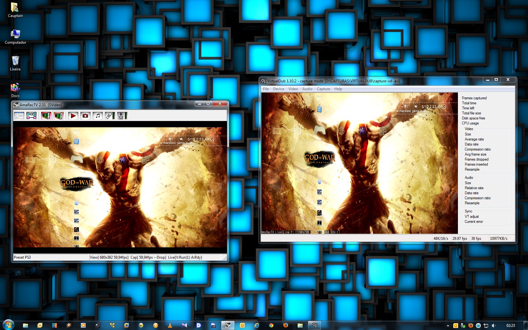

    vaporeon800 is full correct. Only use tricked drivers + AmarecTV live feature. Its will work for your broadcast using ANY program.
    Claudio

    Originally Posted by webvid View Post
    It's capturing for a split second like the other programs then going black.
    On my Pc capture fulltime allday
    Claudio

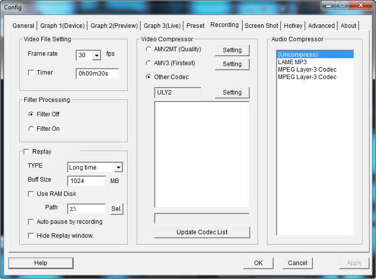

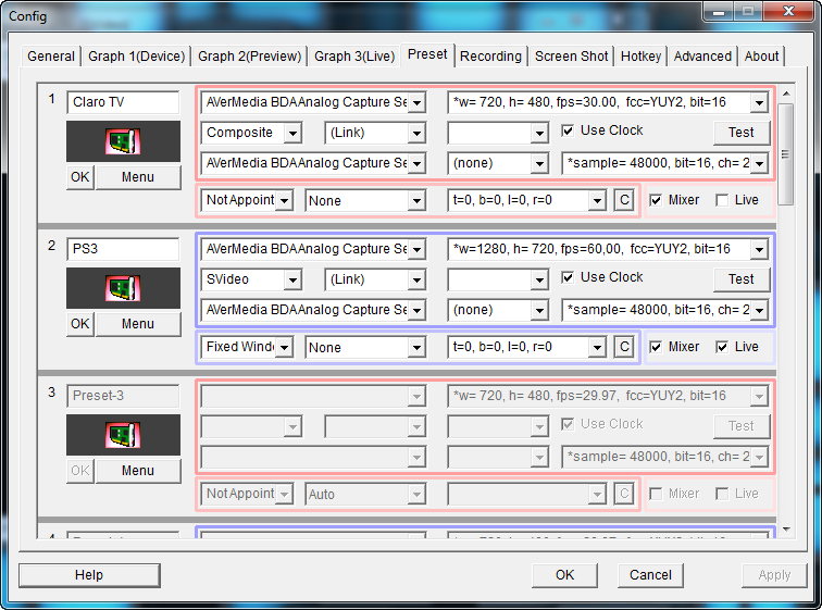

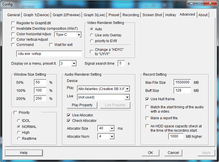

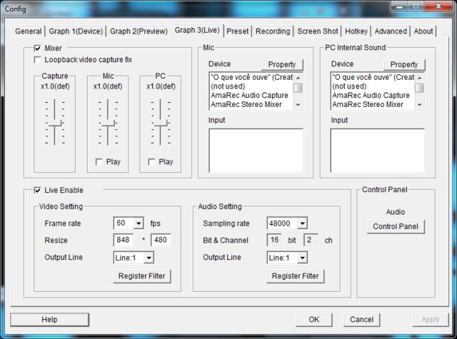

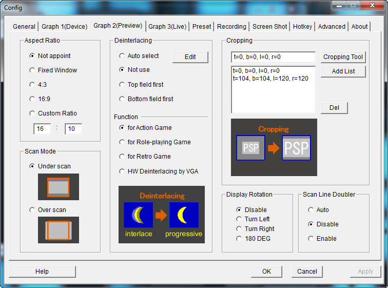

    My AmarecTV config:
    After config, run AMC to enable tricked driver and stream using desired software.
    Claudio
